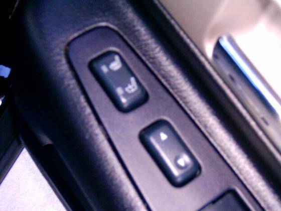

Its a '05 Ultimate, and i must say that heated rear seats is absolutely necessary here in Florida, what would i do without them ?? It is a nice feature though that will never be used.
Sure wish I had those here in Michigan! Say, wanna make a deal? I can send my switch plates that have just the one switch for the window so your car would be ok.... I have black interior so they would match perfectly. I've been trying to find a donor car to get these from for my '06 but haven't had any luck so far.... My home email if you want to talk - rboyer1@att.net.
