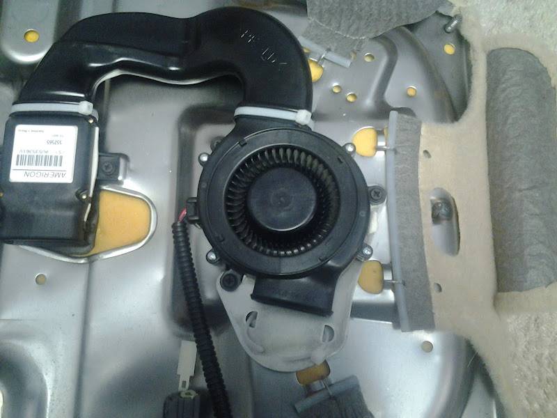

Move the seats up and forward. Reach up under the seat from behind, and the filters twist off.
  • Here's the seat as viewed looking up from below it. (left is the rear of the seat)

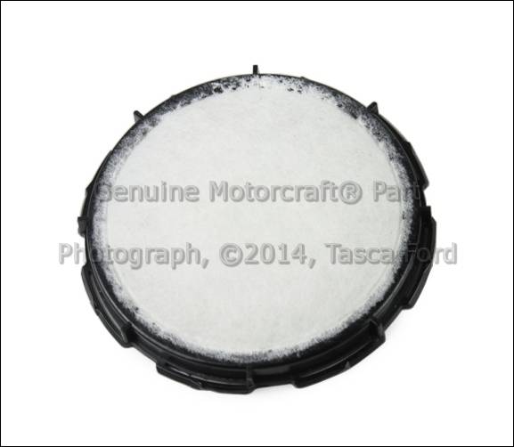

  • Here's the actual filter.
This shows the part that the filter screws/twists onto.
