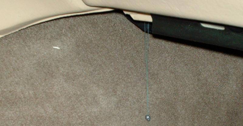

On mine, the blend door is bad also, but since I am in Florida and it only gets chilly here, I just cut myself a piece of wire about a foot long, then looped it around the actuating arm and twisted both ends to make it a draw string of sorts. When it is chilly enough to use the heat, I just turn it on and pull the actuating arm and turn it on high to keep it open. Then just tuck the wire up out of sight. Not worth the effort for me to tear into it just for a couple of occasions of needing heat.
20 lb. fishing line FTW

Do you have a pic of what that is connected to?I used to have a longish metal arm that hung down that i could get heat or a/c with but it fell off months ago.Can i still rig it?
It's looped around the grey arm where it connects to the metal arm, if it's gone, there's no hope......
To 350TPI, You may get lucky like I did, go to ford, buy the little gray arm for 6 bucks. Then make sure you have the old pieces and see if the new one goes in the hole, you will hear it click if it goes in all the way. Then you can do your string trick.
