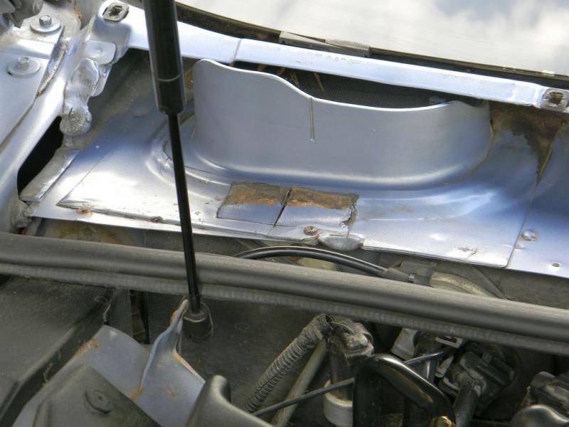

The vent under the cowl panel leaked and probably got some of the electrical connections wet on the blower motor..probably once it dried out it worked. I'd take the glove box down and dry all that stuff out and do the vent fix under the cowl so it doesn't keep happening.
This.
Remove wiper arm
Remove cowl cover
Buy some black rtv sealant
Slather it around the air intake seam, you'll more than likely see where the breach is.
While in there check to make sure the foam weatherstripping (4-5" iirc) is still in place under the cowl cover. It will help block water that slips under the cowl from getting to the area.
Fixed this twice!
