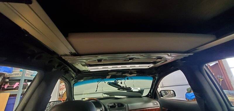

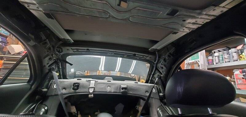

I have a '00 LS with a sunroof. I am in the process or completing my interior change out to all black and I pulled the headliner out this weekend. I do plan on keeping the car so I am not looking for quick fixes but smart maintenance for longevity.
My question for others is what maintenance would you be doing on the car with the headliner out?
Here is what I am thinking right now. I do have an issue with the motor or the timing of the sunroof. I can get it to open and close, but it is difficult to do. I am working finding and repairing the issue. Might need another motor, or maybe just to be timed again. I will figure it out.
I hear constant issues with the sunroof drains leaking. An inspection of the hoses does not reveal any cracks or brittleness. I thought it might be prudent to replace the tubing to unsure no long terms issues. I have not had any leaking into the car or the trunk from the sunroof. Has anyone replaced the drain tubing and if so what did you use? Just rubber tubing or maybe vinyl tubing? Should I just keep what I have in and not disturb what is already working?
I was also going to replace all the cartridge bulbs in the overhead lights. There is some evidence of them melting the plastic housing slightly and I was thinking of going to LED bulbs. Does anyone have recommendations bulbs that aren't too blue?
Anything I should look at with the rear defroster grid at this time?
I don't believe there are any grounds in the roof that would need to be cleaned up but I will check for that. I will also hit ALL the electrical connections with QD electrical cleaner before getting this back together.
Any other suggestions?

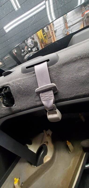

BTW, should anyone be parting out a Gen 1 with a black interior I am seeking the middle seat belt in the rear in black. See pic, mine is gray.

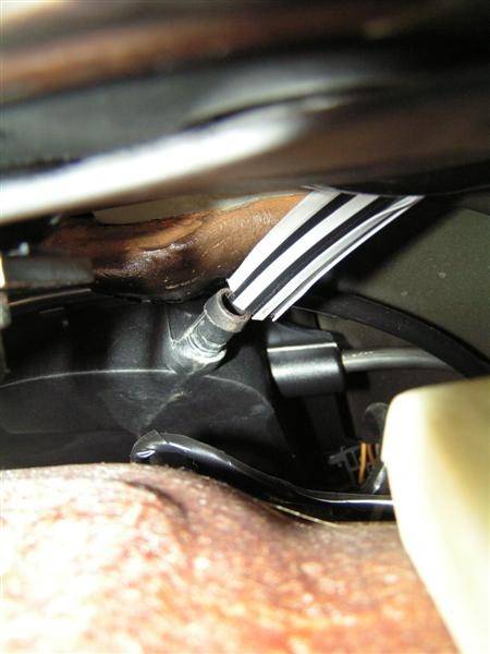

The sunroof drain tubes don't actually crack... but instead shrink in length... and pull off of the drain tube nipples on the sunroof. This is what causes the pillar posts to get wet... and water ending up in the kick panel where the fuses and relays (and PCM) are.
Also why people end up with water in the spare tire well.
The drain tubes are a fairly stiff vinyl (at least on the Gen 2)... so the easy fix is to add a few inches of rubber hose using vacuum line nipples and old fashioned 1/4" fuel line spring clamps.

No... What I am saying is that the drain tubes shrink in length... and pull off of the nipples on the sunroof.
Thus the suggestion of adding hose at the sunroof end... using the vacuum hose nipples and fuel line spring type clamps I mentioned.
Yes 04_Sport_LS is correct. The ends pull off the Moon roof drain pan.
Hard to see but this is what it looks like;
I pull the tube up and add a hose clamp so I never have to go back and do this again!
