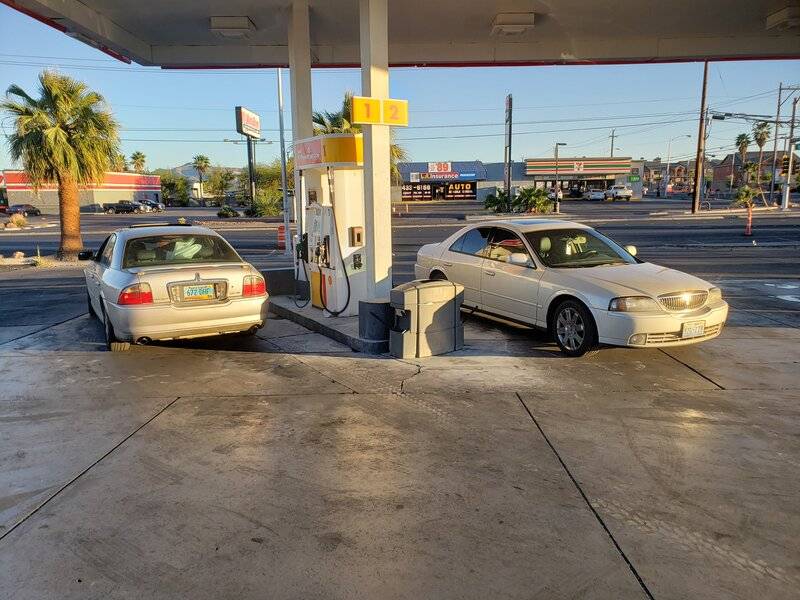

Makes sense. I usually see a bunch of the same vehicle that I'm driving everywhere, but I haven't seen any other Lincoln LS on the road to be honest. Lots of mkz though.

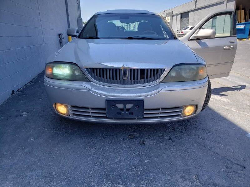

Hey look what I finally saw! His headlights looked kinda crappy too. Ha

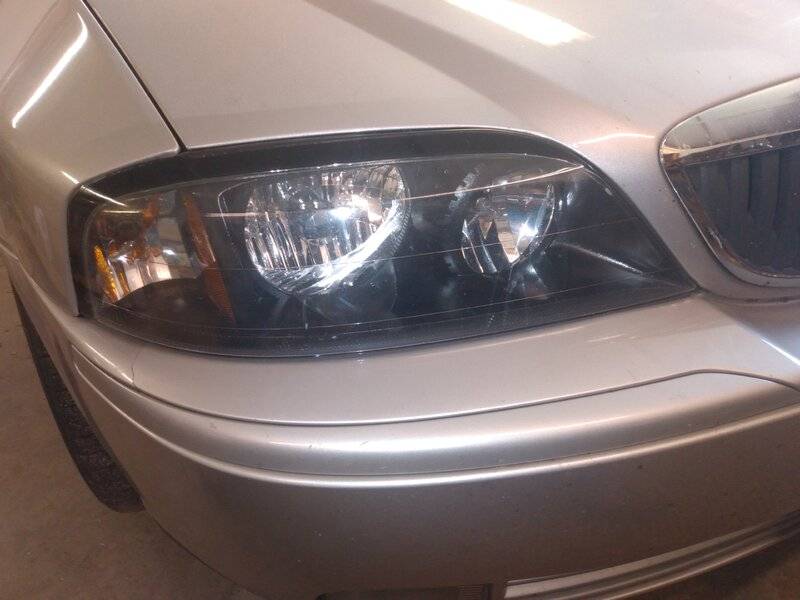

Passenger side with coming up on 235k miles. The drivers side has a slight bit of clouding in the light clearcoat they put on the lenses.
I can scratch it loose with a thumbnail. Both lenses have been polished with Flitz... a few times over the years.
Yes that looks really good, gonna have to do that for sure, thanks.

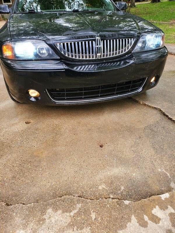

Mine look like this, put a new bulb in the driver's side but it still doesn't work.
