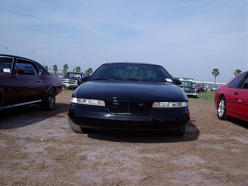

I think i'm gonna do the driving lights behind the grill mainly because I like the way it look's anybody know of some cheap ones that work good? i know to look for 55w with glass lens
I just got some from auto zone, dint help the prob much but looked cool at night and I had it riged up to come on with the auto lights.
Unfortuntlly that car is smashed and sitting in my back yard, but my new mark is going to be painted the same way but iI will leave the star up front and still shave the other logo's.
