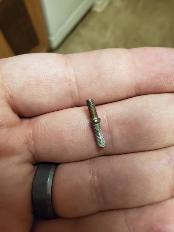

I checked the mount tabs only one is broken and its on the passenger side, however it occurs to me i only have two out of three of these posts on the drivers side headlight bulb holder and it didn't have a retaining nut on it, this post came out of the headlight lens that was destroyed in the accident. I pulled this post for the picture so yall know what i'm talking about.
