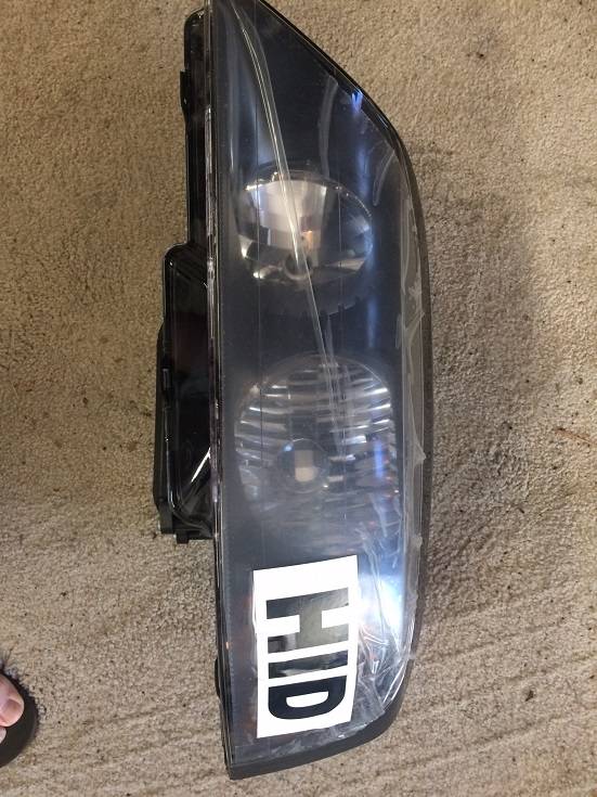

I have for sale a never used/installed driver's side HID light in my garage. It even has the plastic still on the lens.

In addition to looking for the sticker on top and the ballast underneath, they have different shields. Gen 2 Halogens have a smooth spherical shield over the low beam bulb. Gen 2 HIDs, as pictured above, have a disco ball shield
(All gen 1s are halogen and have a pointed hexagonal shield)
