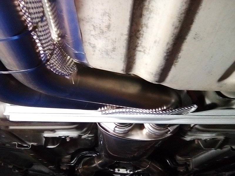

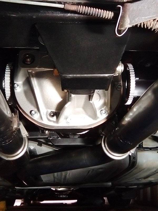

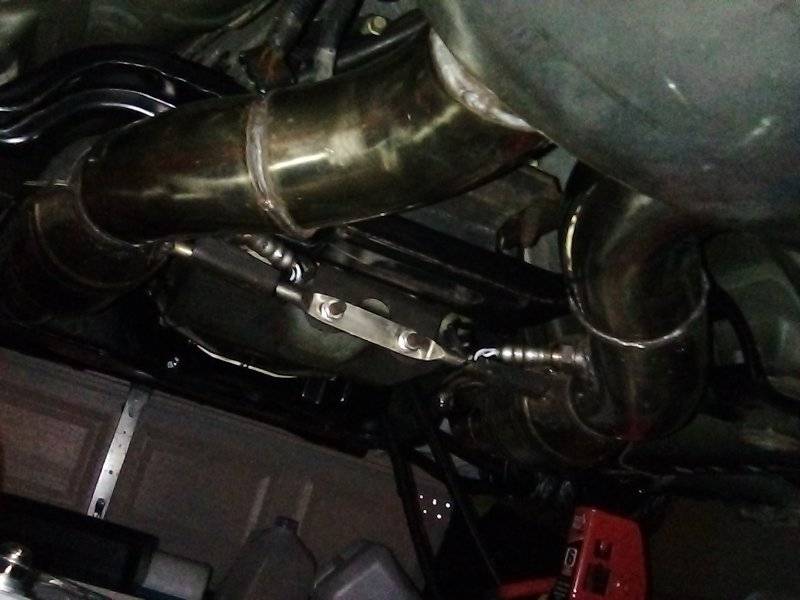

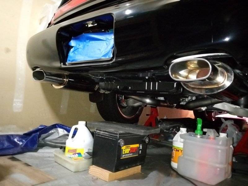

My 1998 Mark VIII LSC has Kooks headers from Supercoupe Performance, twin cats, a Borla 2 in/2 out center mount muffler, and it's 2 1/2" stainless steel "Trubendz" (very poor fit, but I got them in) back to a pair of Chinesium resonators. Bottom line...absolutely noticeable increase in power, responsiveness, miles per gallon, and the car sounds incredibly better; because the stock exhaust manifolds are very restrictive. However, the results would be significantly less impressive with just headers patched into the stock exhaust system. I am very happy with the improvement and, for me, it was money well spent. Hope this is helpful.

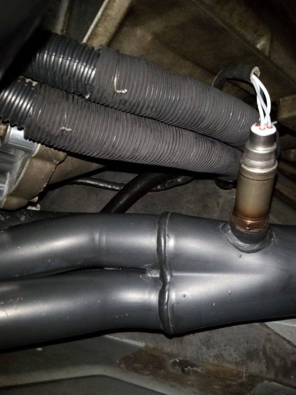

I'm in the People's Republic of California, but for five years I've had no problem with smog checks...for four reasons: (1) it's an LSC with OEM true dual exhaust; (2) the headers come with bungs for the oxygen sensors - all my smog junk is fully functional; (3) it's got 75,000 pampered miles, so the engine is tight and the smog numbers are very low; (4) the engine compartment is so cramped that the (Cerakote heat barrier) powder coated (flat black) headers are not readily apparent. I fitted all the pieces together, then paid a performance oriented shop to weld it up. They don't do smog checks; understood that it would be legal - but didn't really care. On smog checks - including once at a "Star Station" (more finicky) - the tailpipe numbers are so low, and their OBD checking computer is so content, that they've never even bothered with opening the hood.

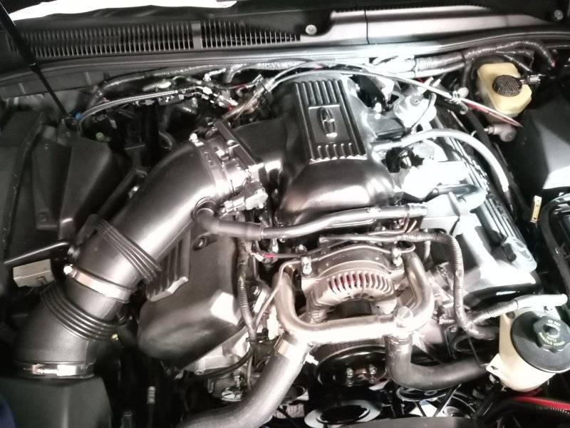

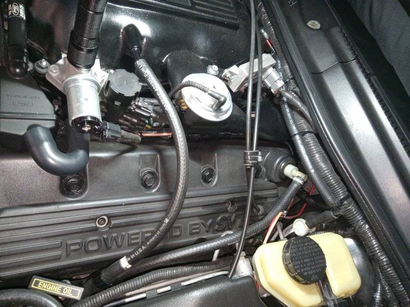

The Borla part number is BOR-400286; it's 2.5" inlets and outlets. I apologize for the typo in my June 29th comment, I never noticed it until wonering why you were looking up a 2" Borla. The Supercoupe headers made by Kooks are very high quality and a perfect fit in the extremely cramped engine compartrment; little known fact - the car was designed for a V6. Also, The headers require use of O2 sensors with extra long cables - also available from Supercoupe. If I was in Ohio and didn't have to smog check the car, I'd buy the true dual exhaust from cats back at a wrecking yard (preferably a do it yourself yard - my favorite auto parts store!) from an LSC. I've seen plenty of total rusted out hulks with perfectly good exhausts, for some reason the OEM exhaust pipes seem to really hold up well. Here are photos of my full OEM Cobra intake swap, I'm very proud of it - all smog junk fully functional, and I did all the work myself - including rewiring and redirecting the entire engine compartment wiring harness to clear the EGR pipe.
