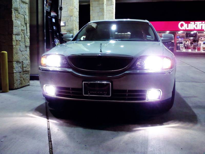

Here is a cell phone shot I tookk last night.
Can't tell how clean they are
