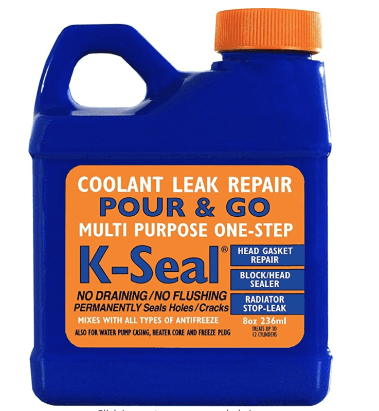

Although replacing the head gasket is the correct way, I have used a headgasket fix that has worked quite well for me.
It's called Kseal and no I haven't used it on my Mark VIII but, my 4.3 C1500. I overheated the truck bad when the radiator blew out while driving on Rt78. So after I put in a new Radiator it was leaking out of the back of the cylinder head pretty bad. Also into the one cylinder pretty bad too. Talked to a mechanic friend and he said use Kseal cause he put it in his Ranger a year ago and it still was working.
Bought it at AutoZone and mistakenly used it with no antifreeze. It didn't do squat until I used antifreeze and now I have been going 2 years without having to fill it up constantly. It really still needs a gasket but, I know I warped and cracked the head so I have been just stringing it along till I switch to a V8 in the V6's place.
