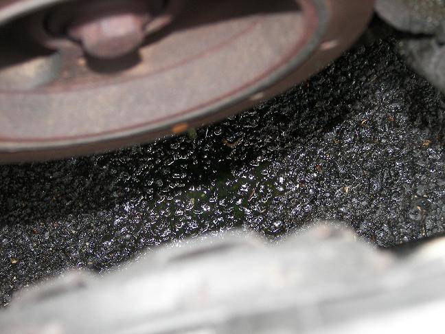

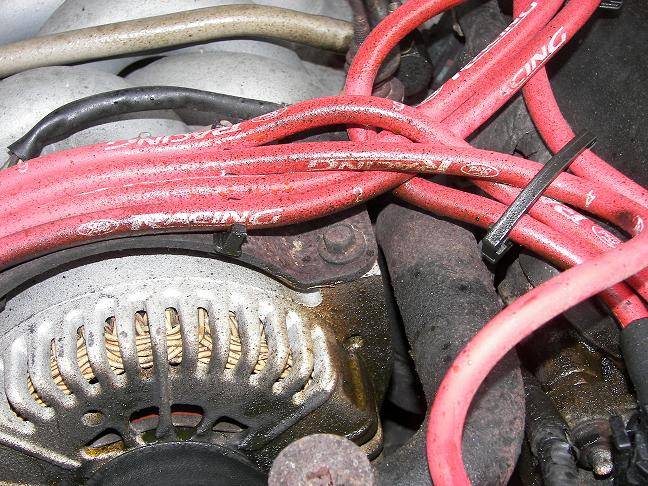

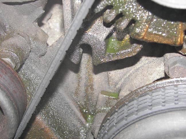

Ok so I've noticed I'm leaking a little coolant over the last few weeks. I tried the radiator stop leak by bars and it helped a little, but now its bad. It looks like its coming from the drivers side of the engine, maybe a leaky head gasket? I'm gonna go pick up some head gasket repair stuff as well as antifreeze, what do you guys use, I've heard that bars makes a head gasket repair fluid that people say works? Oh yeah, and I've been getting an annoying sound from my belt but it looks like the leaking antifreeze might have something to do with it. I don't like how the middle pulley looks a little wobbly. I'd like to get that annoying noise to stop, it looks like its coming from the alternator though. And now for the pics...

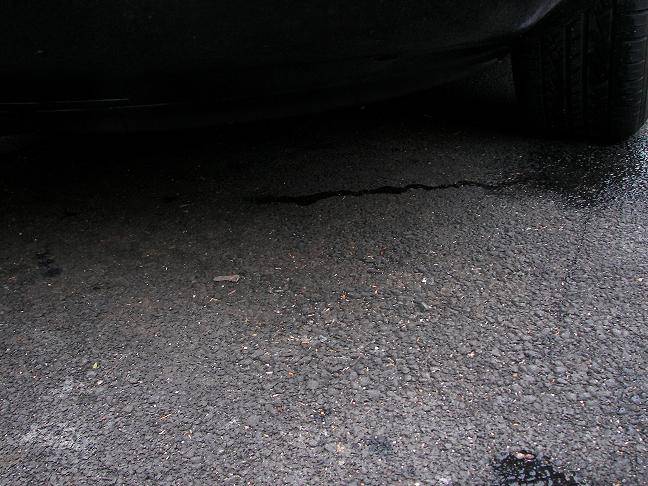

the last pic is a bit of the leaking I'm getting after being parked 10 mins with the car running. Oh and the red stuff on the overflow is the radiator stop leaking that I spilled and am too lazy to clean up.

The funny thing is I've never overheated, my engine temp needle never changed, the only reason I noticed was looking at the small puddle under the car. I let the car sit for my entire shift yesterday, about 12 hrs and it had a spot the size of a half dollar under it, but after taking it home this morning and filling it to the top it leaks a little faster while running. My exhaust smells fine, I mean I don't have mufflers and it smells no different than it ever has. I've flushed it out as best I could today. I'll check for hoses as well. Until then unfortunately its my daily driver so I have to baby it I guess. Should I even ask if a head gasket is something I can do myself?

and that stuff going into your alternator almost guarantee's it's going to fail...
Well XLR you're probably right about the hose. I went out and took a better look at it just now, its not leaking from the top of the engine (that I can see) it does drip pretty fast though from the middle of engine up front (see pics) and another video...

the belt is squeeling because anti-freeze got on it. it will wear off, but it will take forever. some belt dressing might help some too.
ok, first where is your bottom alt bolt in your first pic? second its not the head gaskets, they wouldnt leak on the front of the timing cover and alt unless it was spraying everywhere under the hood and that leak would be quite obvious! as for the vids, holy hell it sounds like your water pump is eating itself, try taking the belt off and see if that noise stops, if so replace the water pump and i bet the leak will be gone it looks like its getting slung from the water pump pulley.

Chicken: I actually just noticed I don't have that bolt yesterday, what size is it? I'll have to go pick one up. I was starting to lean toward the waterpump myself because it wont leak very much if at all when it's off, but as you can see in the videos while its on it leaks pretty fast. What did you mean by taking the belt off? I'm going to do some research on the prices for waterpumps & what not, is this something I can do in my driveway with handtools and jackstands?

The water pump is easy. No jacks needed. I think 4 bolts, maybe 13mm, hold it on. Then you pop it off and put the new one in. Make sure the new pump has a new o-ring seal, if not get one. Pumps are not expensive. I think I paid $40 for my Cobra one.
Just pull the belt completely off, start the car, if the sound stops, it could be a faulty water pump. You should be able to spin it fairly easy, if it feels rough, replace it. It could be done in the driveway with the tools you listed. I don't have any idea what a shop would charge you, it never hurts to call and ask.
Got the pump and it looks like I'll be able to do this with no problem, JUST TO MAKE SURE....the water pump is behind the pulley right under the alt. right? because its spewing antifreeze from there
