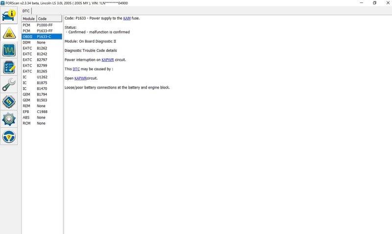

I have recently having issues with my fob, once the car goes to sleep, I am not able to unlock my car with the fob, thankfully my door lock module is broken so it never locks the door automatically so I am able to put the key in the ignition and when I turn the key to accessory, the fob works again.
There is also slow start issue when i turn the key completely on in one motion, but when I turn the key so the accessories turns on the car starts normal.
I had recent installed a 1000watt rms amp and subwoofers literally the day I noticed the issue. Pulled everything out and still the same issues.
Checked the transit relay fuse(wasn’t 100% sure whether or not the gen 2 3.0 had one but I checked all fuses regardless)
battery only a few months now old
I’m stumped guys

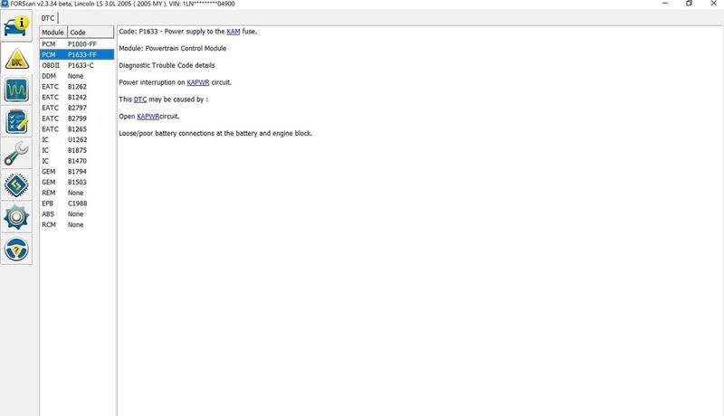

Code P1633
So, fuse F2.07 (#7 in the cabin fuse box, 5A) powers the PCM memory and the DDM's (Driver's Door Module) always on circuits (such as the radio receiver for the remotes). The wire to the PCM is orange/yellow, and the wire to the DDM is orange. F2.07 also supplies reserve power to the rear view mirrors (doors), the parking brake switch, and the driver's seat module and switch.
Fuse F4.25 (#25 in the trunk, 40A) supplies F2.07 with power, but you would have lost a lost of functions if that fuse/circuit has a problem.
