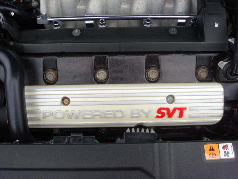

First pic is the coil covers (yours will say intech 32v on them) 2 bolts, 10mm.

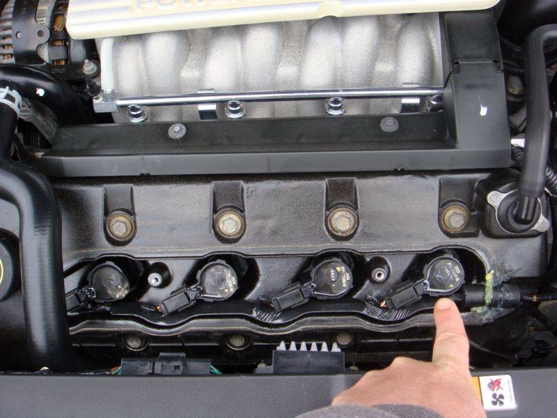

Second picture is a coil pack, pull it out, unhook the clip and you coil is out.

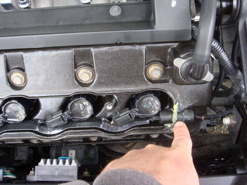

Third picture is where you should silicon the rubber round thingy, top and bottom.
Mine was just the plug when it started missing, yours might be to, but could also be the coil pack. Get Dieletric grease to pun on the new coil pack when you install it, I put it in the boot, on the boot, and around the seal. Just alittle tighter then hand tight is all you need to put the coil pack covers back on. Unhook battery for 5 minutes to clear the code. For someone thats done it before its a 5 min job. This should be real easy for you to fix yourself. GL.

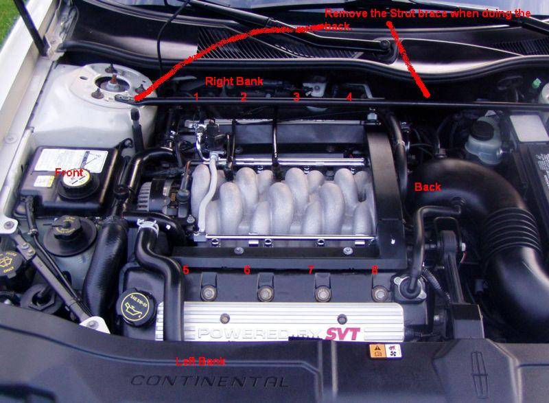

Here's a pic of cylinder order. This is not the firing order. Try not to drop the back coil cover bolts. You might not see them again.
Thanks for the exceptional advice and pictures!
That was great, thanks so much. I am sure I can do it, figures it is the ones at the back of the engine.
