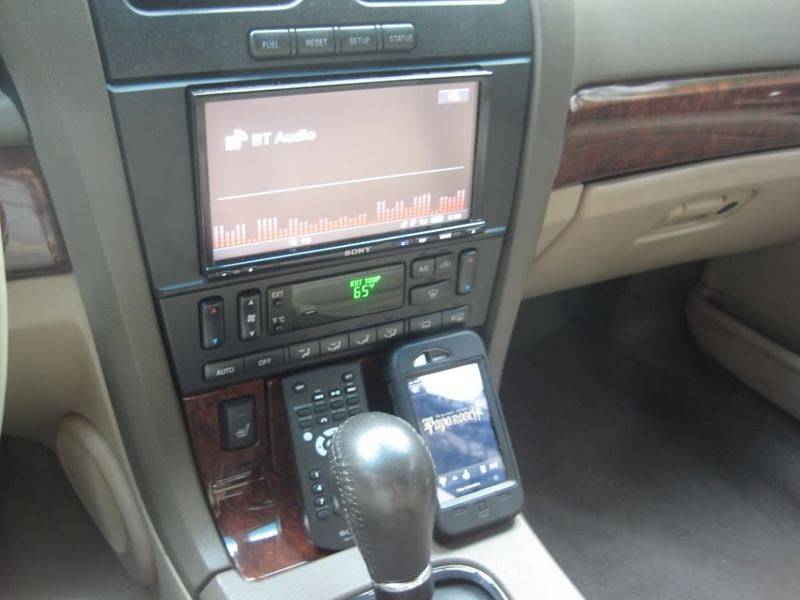

Crutchfield said that this would not fit. If you can come up with the dimensions of this one (Sony XAV70BT I believe) just dont go any bigger. I think if it was 1 MM deeper it would not have worked. Installation was a challenge, but it is doable!!
