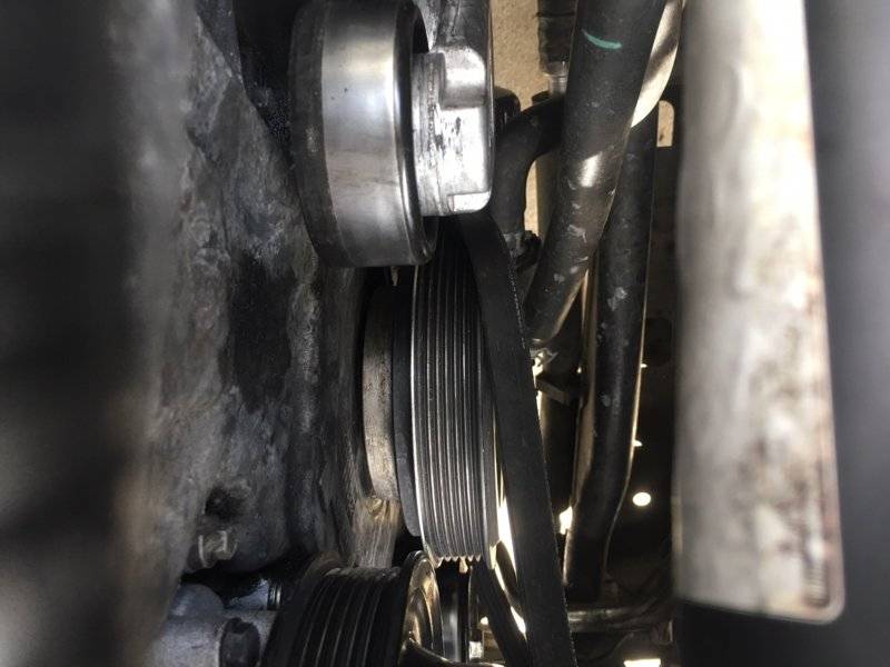

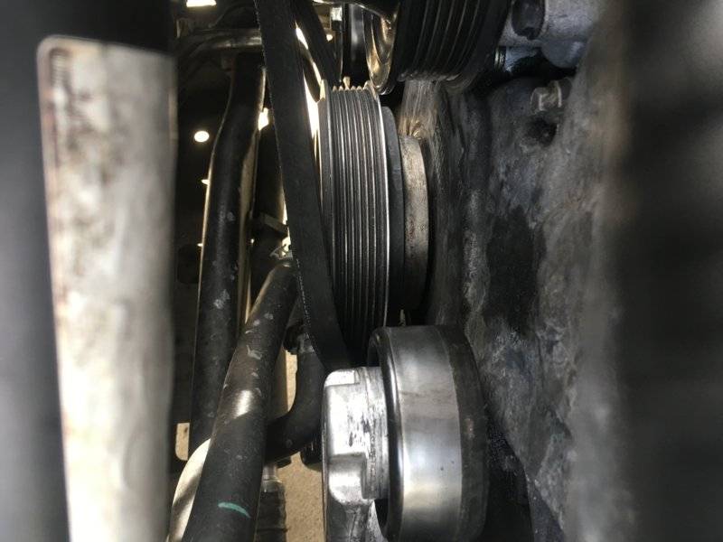

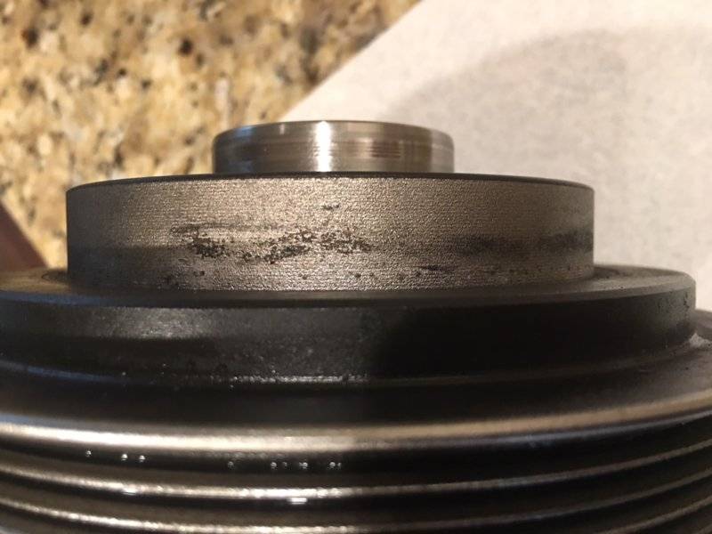

is mine coming apart or coming off? It is less than a year old.
I feel like I must be looking at that wrong...
That looks like way too much room between the pulley and the timing cover, like the balancer is nearly off the crankshaft.
Yes, what I am trying to determine is if the balancer is coming apart or coming off. It is NOT where it should be.

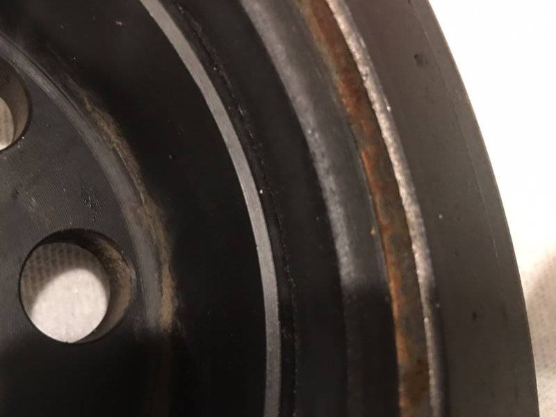

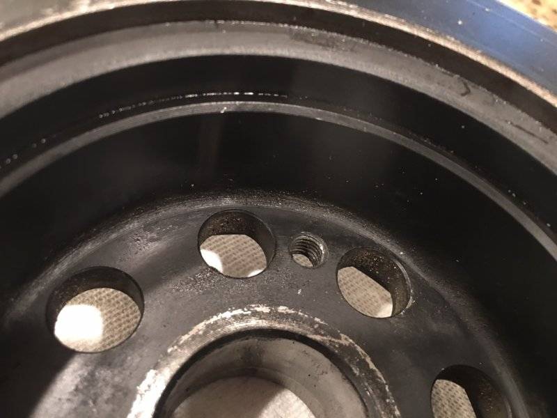

I looks like the bonding between the two parts where the rubber is has come debonded.
Well, that sucks. At least you caught it before it did serious damage.

The rubber part on mine was migrating to the back. Fortunately, the timing cover stopped it from going too far. Also very fortunately, the pulley stayed at the right depth.

It was a Dayco from Rockauto that I paid $350 or so for. When I asked about the belt, the reason I now see, that it was damaged was that it was rubbing on the oil cooler and now I am down to 5 ribs rather than 6. I may send that back to for a replacement since the defective balancer caused my belt to break. Worth a try.

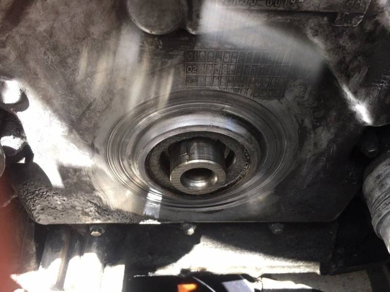

I got the balancer off. Rockauto is doing the warranty for me but they don't make it easy to get the replacement part quickly. Here are some pics with it out. You can see the center, rubber, and pulley pieces that should be lined up.

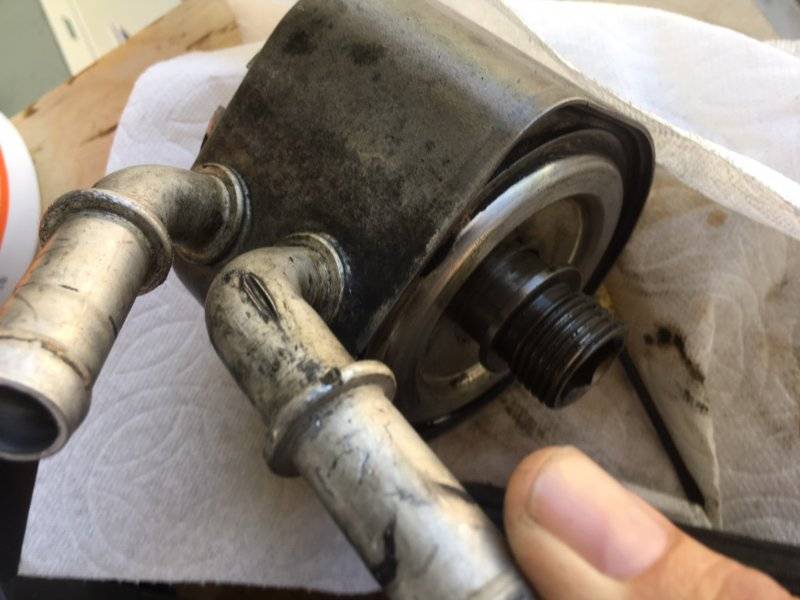

Take a look at what the balancer did to my oil cooler. I don't think it is an issue but it did put a very nice groove in it by rubbing on it. Same for the engine cover.
I am also going to put in a new crankshaft front seal while I have things apart. Might as well do some upgrades while the car is apart. I have read a few threads about the crankshaft seal. Is there a specific brand that is better than others? Felpro, Mahle. Timkin?
