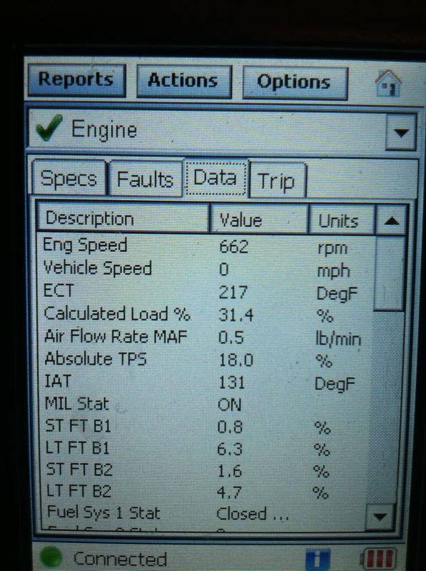

in the meantime, anyone know why my engine load would be at 31% at idle? doesn't seem right to me.

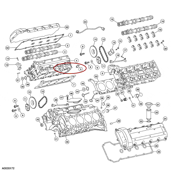

Cylinder Head Temperature (CHT) Sensor —3.9L
Removal and Installation
- Disconnect the cylinder head temperature (CHT) sensor electrical connector.
- Remove and discard the CHT sensor.
- CAUTION: The tip of the CHT sensor must contact the cylinder head at the bottom of the hole. When removed, it will be slightly crushed. This is a normal condition.
-NOTE: 3.9L CHT sensors are not to be reused. Always install a new sensor.
Item 4: p/n 6049 - Cylinder head, RH
Item 5: p/n 6G004 - Cylinder head temperature sensor, RH

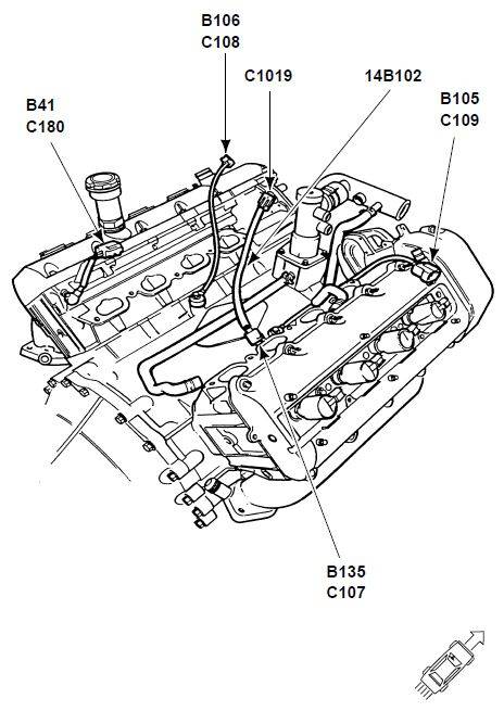

^ B135 = Cylinder head temperature sensor
Might be on it's way out or just corroded connection.

Use your scan tool to monitor the temperature sensors.

ill check the scan tool tomorrow for readings.. but as of now i believe i might have a simply plugged up thermostat or a few cracks not allowing me to build sufficient pressure. or the possible bad sensor because its so randomly happening. although you'd think if i had a few cracks id have some leaking coolant too?

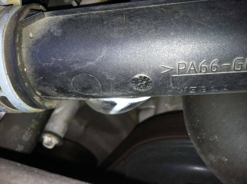

Bigrig had a pic of his degas bottle, the cracks were so much like mine he may as well have posted a pic of my old bottle. Yes, you have a leak, and since you have to bust the system open anyway go ahead and replace all the hard plastic and the hoses. It's not hard to do, just a lot of "what the hell were they thinking" things. Expect to remove the upper manifold plenum to get that one plastic neck off, for example. They could have used 1/2 inch shorter bolts (which mine now has) or moved the bolts 1/2 inch closer to the front of the engine and the intake wouldn't have to come off. I didn't even have a manual and the job went like I'd been doing it for years except that someone who does it for years knows how many gaskets they need to have on hand. :eek:
