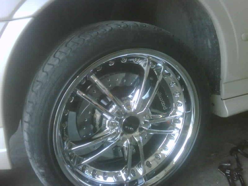

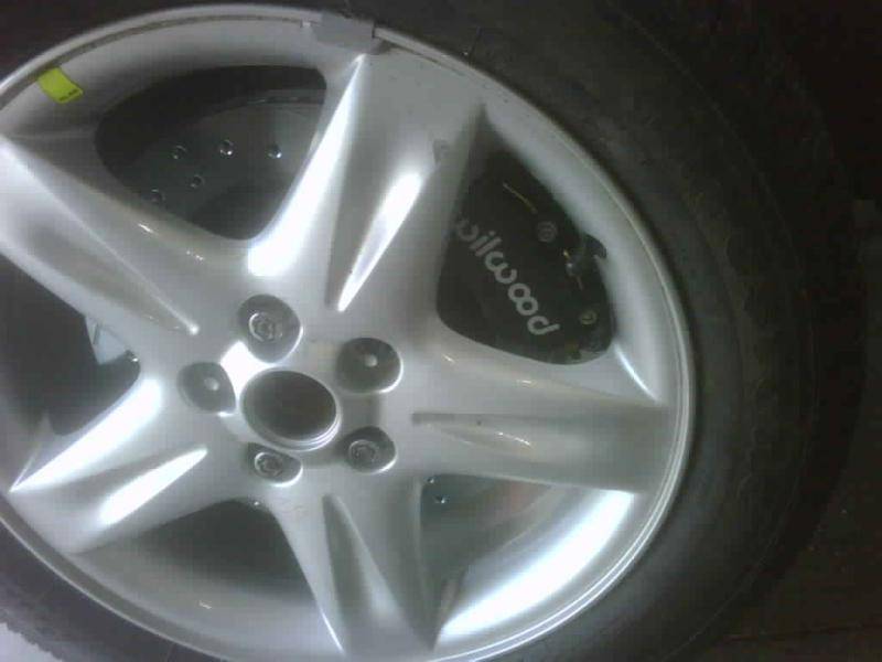

I love my Wilwwod noticed a huge difference going with a 4 piston caliper and 13 in rotor. Plus they work with the stock 17s and the aftermarket 19s
I made the bracket myself to save some money.... but the calipers, pads, rotors and hats were about 1400
