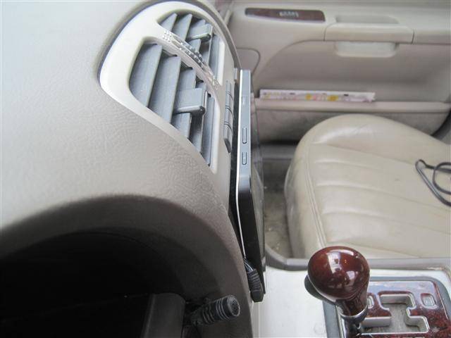

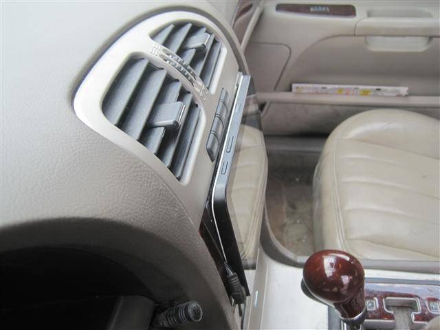

Got rid of my double din and replaced it with a 7" Galaxy Tablet
I redid it a few times to get it as close as possible.

Good work! Whats the object below the seat with wires going to it? A speaker? Do you have flip it down the tablet manually? If so and you want to take it a step further, I found some pretty cool linear actuators you can use. You could just use one, wire it to a switch, flip down and flip back up. You can get them in various sizes and with different gears for different speed and torque.
Good work! Whats the object below the seat with wires going to it? A speaker? Do you have flip it down manually? If so and you want to take it a step further, I found some pretty cool linear actuators you can use. You could just use one, wire it to a switch, flip down and flip back up. You can get them in various sizes and with different gears for different speed and torque.
The things under the seats are the Aura Bass Shaker coneless subs
(for the loins!) that are powered by the center amp.
Some girls like them:p:p
yes it's manual with the rod on one side to keep it from dropping too far.
Post a link or send me a pm about the actuator.
I'll consider it but it's so easy to use and i just wanted to get it working
and it follows the KISS rule.
I suppose I could put the button on the console where my remote used to be.
Now there's an idea.
