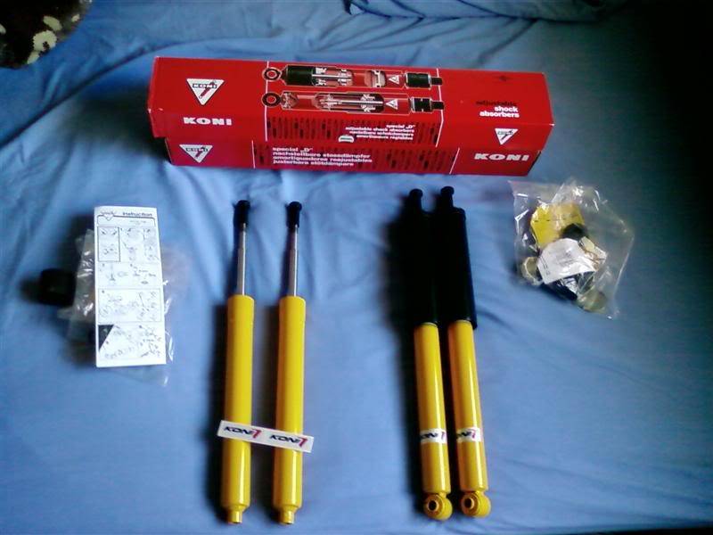

got my Koni shocks...... :)

finally it rides AWESOME!!!!! :D ........floaty front end - G-O-N-E!!!!!! i was gonna take pics of the whole install but i have a cold and been sick for couple days now......... cold+medicine+power tools = FUN

fronts are shock inserts: u have to cut to the top of the old shock off, take the old guts out and drill a hole at the bottom of the shock housing.......were a bolt will hold the new insert.

Front - 8641-1209 Sport
Rear - 8041-1202 Sport
