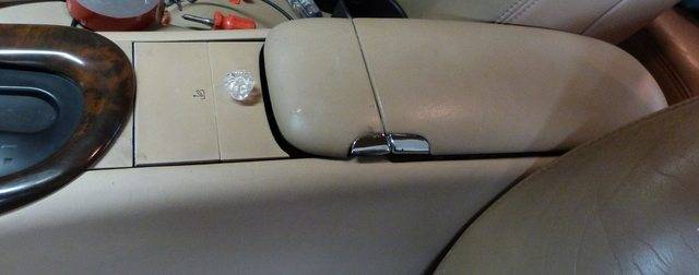

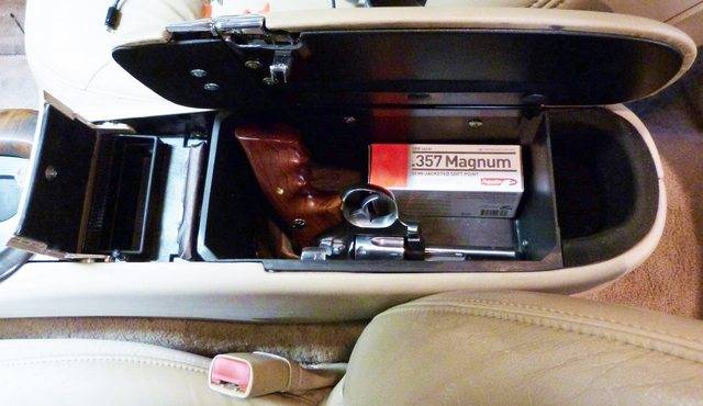

Do you like the ridiculous storage space in the console? I bet most of you have forgotten whats way down in the bottom of that narrow n deep excuse of a storage contortion! So... I added a very extensive reconfiguring. I removed the worthless dual cup holder, grafted the cup top to the rest of the arm rest and built the console around a plastic ammo can. The internal space of the new box is 4 3/4"W x 9 3/4"L and nearly 6" deep. The 2 side rear air ducts were converted to a single under the box air duct that allows for a much wider box install. The lid button was joined to the cup holder button and springs open as it did before.
Having a CCW permit for over 40 years I like that I can fit a full size 357 and box of ammo with a lot of extra space left over now. Ford..... Good they dropped that old moto "A Better Idea".
