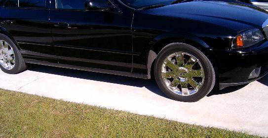

could someone photoshop
onto my car so I have an idea of what they would look like?? Ken you said your selling them for 700? are they mint or are their any blemishes??
I am not a big fan of any of the aftermarket wheels I have seen, so I just want a nice set of factory chromes to replace my machine finish wheels.

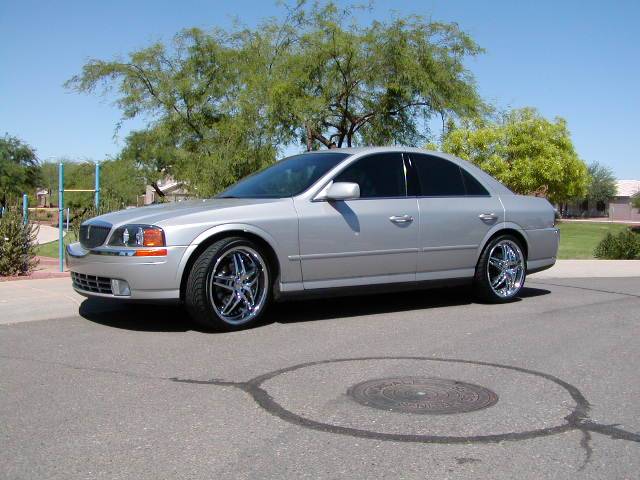

:q:q:q:q i think my wheels look bad ass, but to each is own
