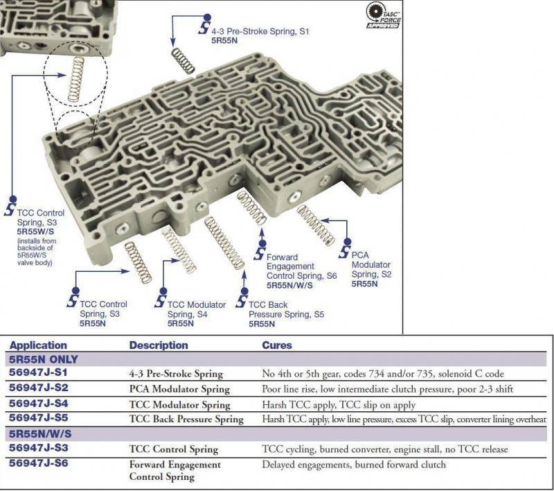

I did some research and found this is a possible fix for our problems.
I think in most cases the solenoid is the true fix and not the pcm.
