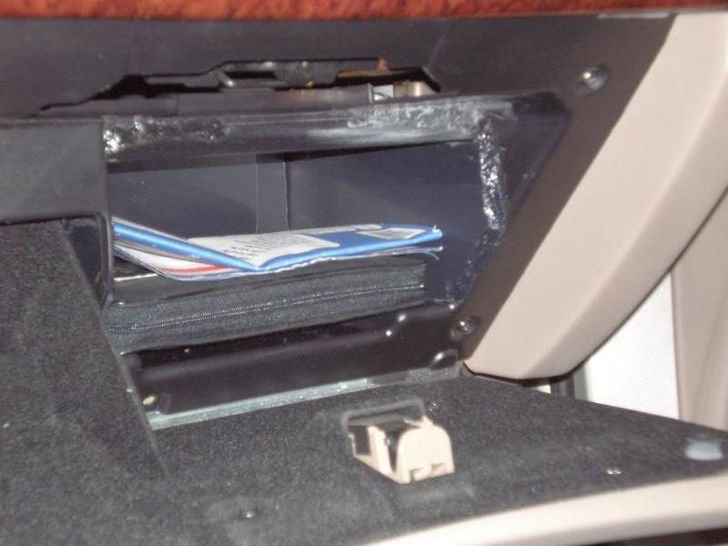

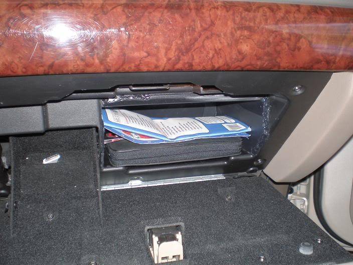

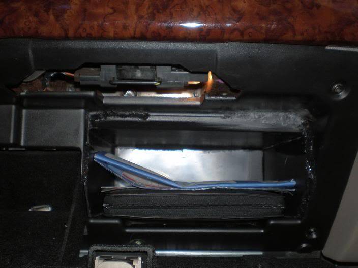

I grew very tired of not having any storage space in this car, so I took matters into my own hands this weekend with my dremel and a soldering gun:
Since I have an aftermarket head unit, I lost the function of the disc changer in the glove box. So I figured, why not use the extra room that the changer took up? I reused the old top from the small user manual compartment, cut it off and moved it up. I bought a couple black ABS desktop file folder holders from target for 2 bucks, and cut pieces out of those to use as the new sides of the compartment.
This was just the dry fit, to see if I could keep it at the same height. I have yet to finish up the pplastic welding, sanding, and refinishing.
Comments? Keep in mind that this is not finished yet...

just finished the first filling/sanding. There are areas that I need to fill more, but here are some pics so far. Remember, this is my first try at plastic welding:

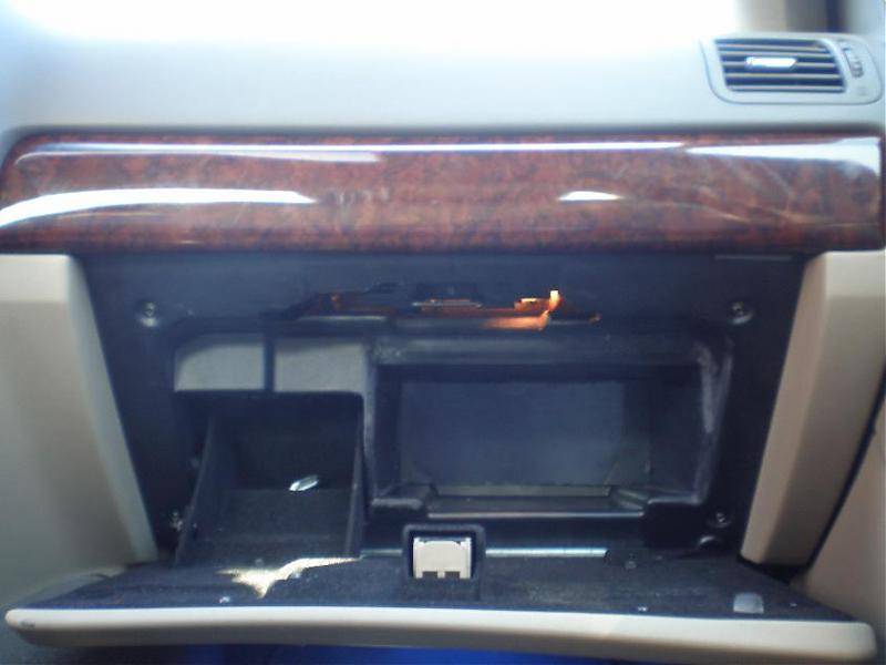

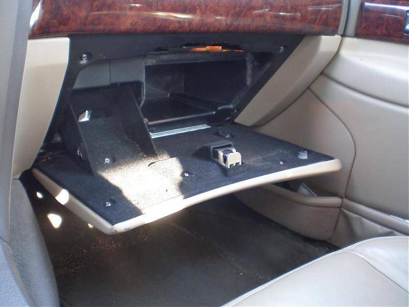

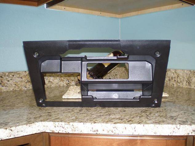

And, for those who don't know what the stock box looked like when it was built for a changer, here you go:
