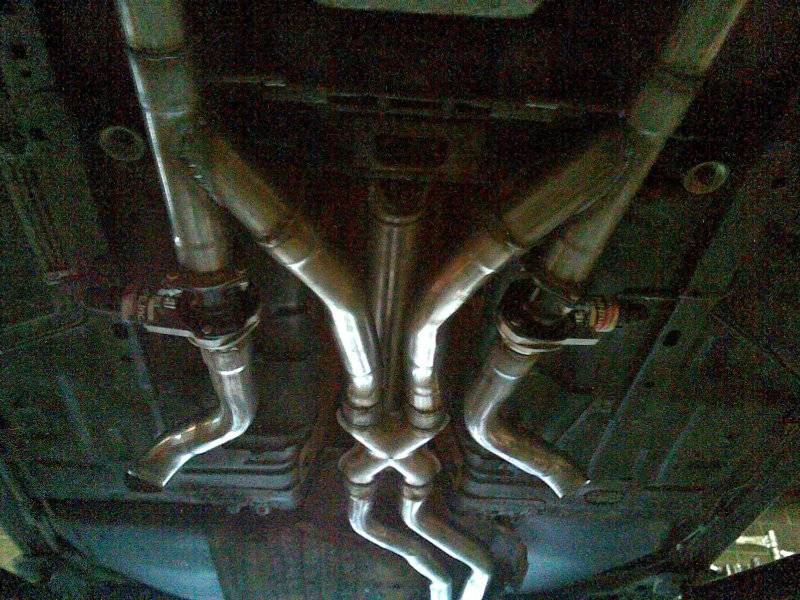

The 3rd Cat was removed from my Lincoln. A stainless X-pipe was installed. Then the pipes were modified to install electric cutouts. The OPEN /CLOSE in 2 1/2sec.
Before.
X-Pipe installed.
Finish welding it out,
Now only if this was a turbo car ;)

X-Pipe = $60
Cutout's = $320
Labor w/ flanges,gaskets, pipe,bolts = $200
It should have been more on that. It was on the rack for 4 1/2hrs and I was right there working with him.
His flat rate is $50hr.

and some 4" slash cut tips
As in 4in long or diameter? The exhaust shop can build them better.
Mine have offset's to keep everything up high.
The is nothing hanging lower than the stock system, except the bottom of the tri flange at the bottom bolt.

2.5" inlet 18" long 4" wide. Maybe too big, I'm waiting for a photoshop. 02lse96lscyaddayadda had some 4" tips that looked mean though, I'm going for that

The X-pipe is stainless. The other pipe is 16ga aluminized steel.

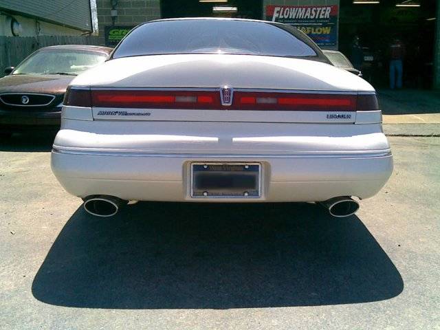

Stock mufflers and tips.
I'm keeping it stealthy. :D
