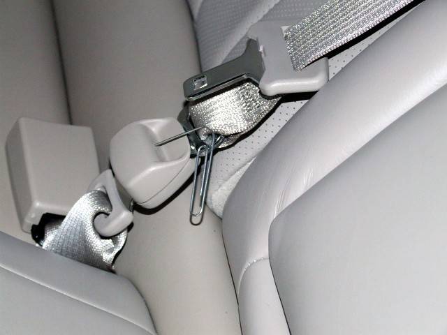

The rear passenger shoulder belt goes through the rear seat cushion with a connector holding it to the anchor bolt under the cushion. How can one uhook the connector without taking out the anchor bolt... there seems not to be a button to unlatch it???
I use a large paper clip.
Thanks I didnt even see that hole there...now where can I rent one of those special Ford/Jag tools?
You’re not the first to ask, that’s an old photo.
I pilfered the tool from work, keep it in my arm rest, had to put my name on it so others don’t take it from me.:D
