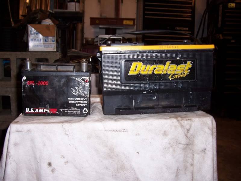

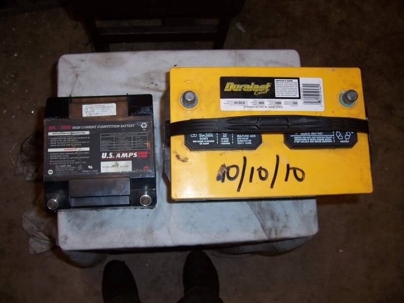

I had this 20lbish 800CCA racing battery sitting on shelf after pulling from green stang. Here you can see the tapered alum battery post made and the huge size differance.Duralast 40ish? I will have real weights soon.

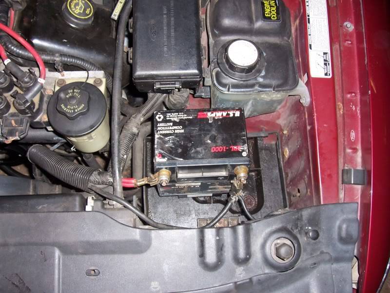

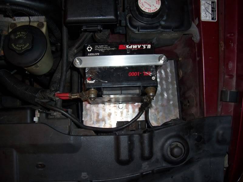

I test fitted and started the car to check battery cuz that sucker is old school. Pay no attention to the broken Neg battery term that will be replaced. ;)

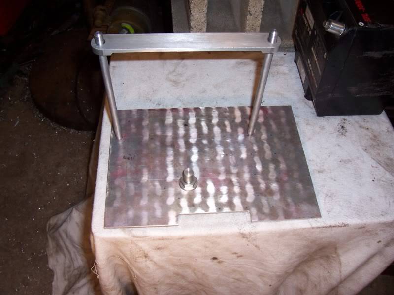

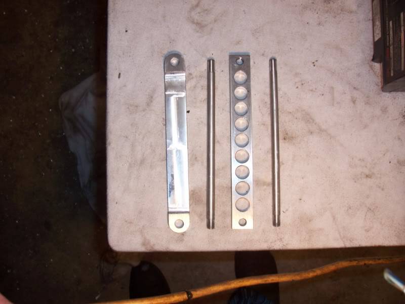

Here are the hold down parts. Directional limiting top strap both 3/8 studs and bottom nut plate. All parts mocked with the front to back limit stud mounted.
I never knew us amps made batteries. How old is it?

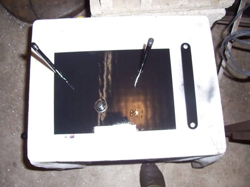

nice battery hold down you made there, but paint???? i think i looked damn good raw, did you paint for corrosion reasons?
Thanks . Only reason to black out,was just to blend in. I was even thinking of blacking out the sweet looking Kirban AFPR. LOL
Taking 40lbs off the front of the car is huge. All the little things you do add up. When you going back to the track?
