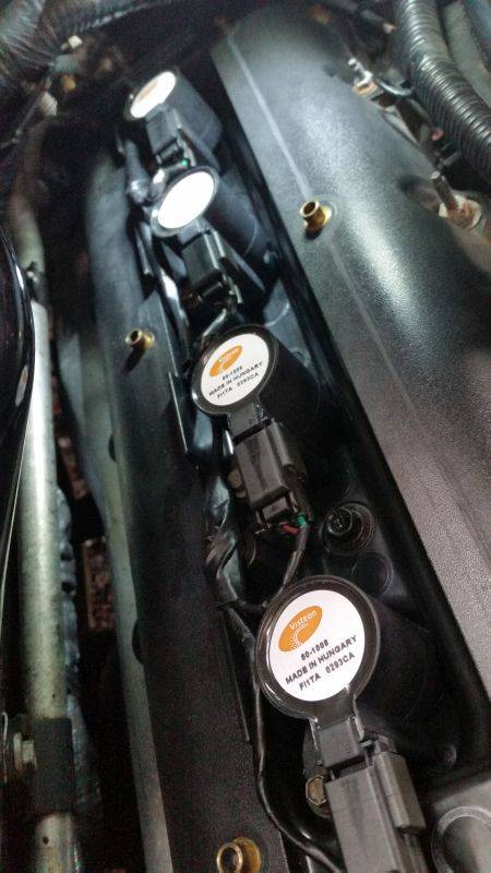

Visteon btw was a Hungarian Manufacturer of coils for Ford. They are top notch coils for sure.
I have them in my 04 LSE V8
See install here if interested.

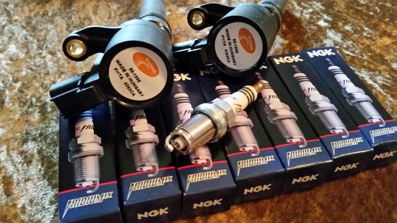

Also i see ngk has a couple different models of that plug. Which one is the perfered?
Just get the NGK Iridium's

Be sure to use di-electric grease inside the coil boots and gap the plugs to 1.0mm
Ensure the coil connectors seat properly by means of clicking shut firmly.
