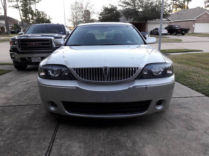

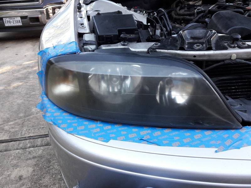

Mine were pretty bad so I picked up the 3M restore kit from O'Reilly's. 45 minutes and three beers all in and voila!
just a warning about the 3m kit...
it does not come with any kind of UV blocking, and you have now sanded off what little bit was still on the headlights.
after I did mine, they stayed good for a little over a year, then the following summer, I was driving the car more and moved to a place that did not have a garage and they went down hill quick, by the end of summer, they were ten times worse then they ever were before.
last summer while I was waiting on my exhaust to get done, I spent a full days wet sanding them down my hand and re coating them. now they actually look better than the day I bough the car. I'm hoping this last a good while, but the car hasn't sat out in sunlight for even 10 hours since then.

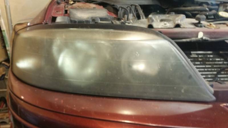

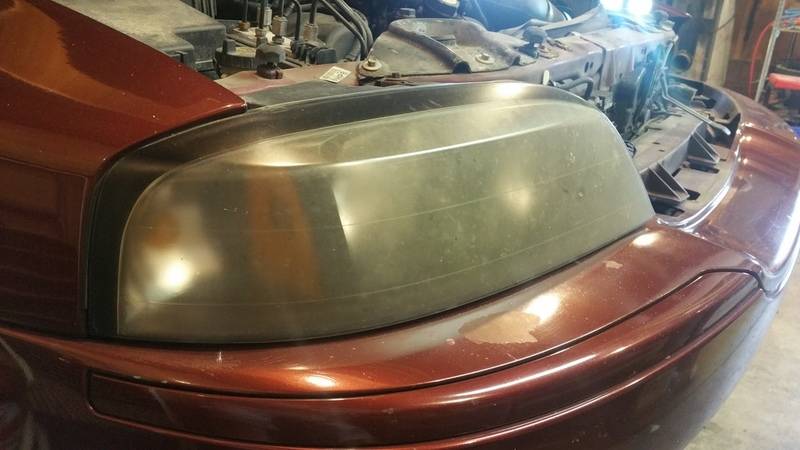

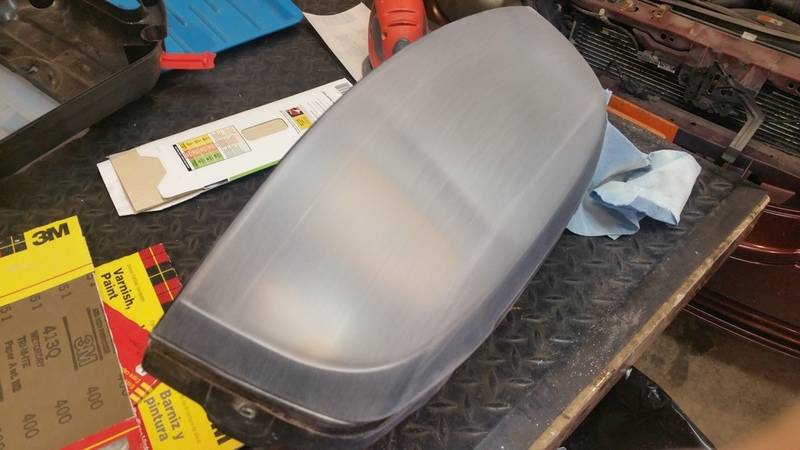

this however, was a little more than a 3 beer job...
this was 2-3 years after the 3m kit got it back to very good condition

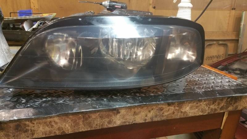

this was after 400 grit

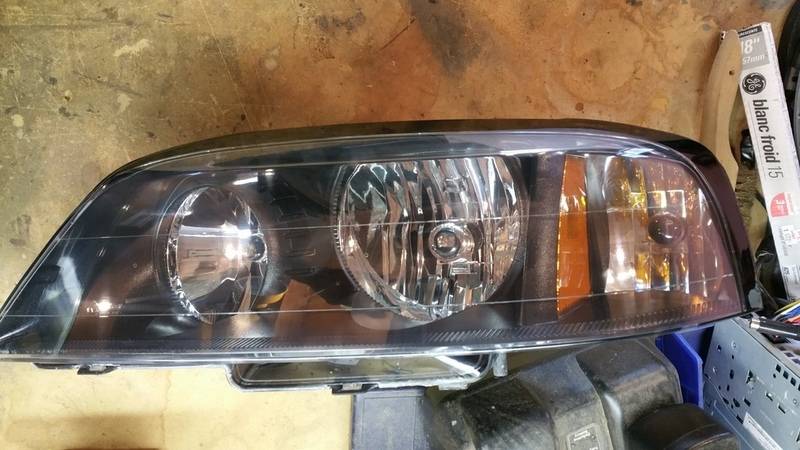

then after 1500 grit

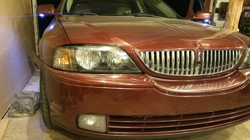

then after the clear coat mix
this was after it was all done and put back on
to be honest, next time Ill just pay for the whole sams club membership!!!

btw: what did you use for the clear coat mix? end result is very clean!

I took a couple of guys recommendations I saw on here for the refinish, it was a mix of Spar urethane with UV blocker and mineral spirits 50/50, also the same thing a friend at a body shop says they use.
Copy that on the "Spar urethane with UV blocker and mineral spirits 50/50"
That stuff brushed on and it simply evens out where no lines from brushing is visible then?
If I recall correctly, the 03 we bought from former member M4rk, he had done the same thing ... and unfortunately couple years later they look like crap again. Which I'll have to refinish this summer.
I used a small piece of lint free cloth, folded up into a small square. and yeah, basically brushed it on. it was brushed on thin enough not to run.
honestly, gonna have to wait it out and see how well it holds up.
