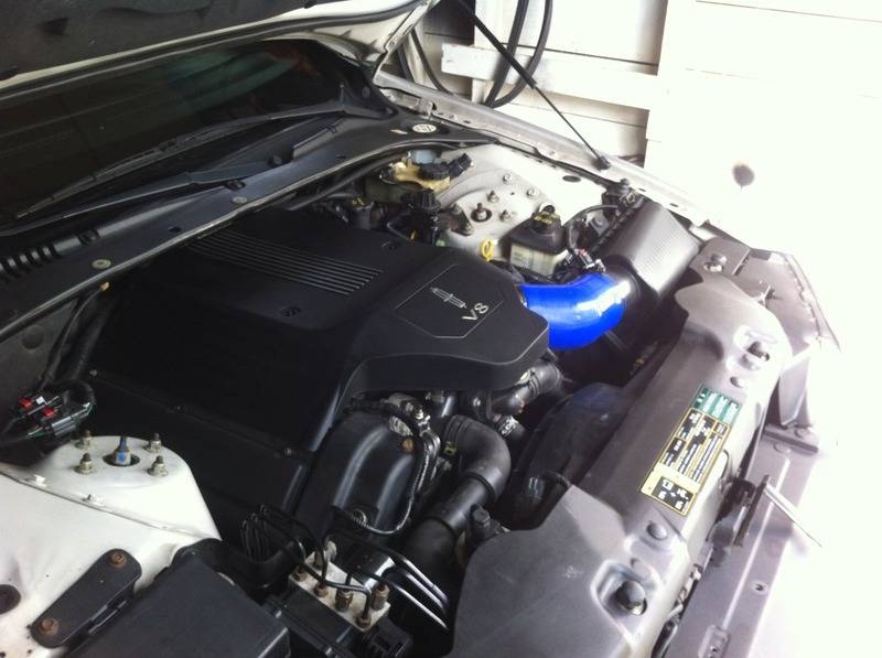

You are probably better off buying some sort of generic silicon elbow, and adding ports for the the Vac and valve cove connections. Since the elbow could then slide over the airbox, and the throttle body, it would be the perfect bridge. They make grommet kits for "tapping" into silcone. Lots of water-meth users utilize that for pre-TB jets.
Like this: (Stolen from an old thread on here)
ttp%3A%2F%2Fi1038.photobucket.com%2Falbums%2Fa469%2Fmlara1129%2FBlueIntakePipeapparentlyfromebay.jpg

Thank you for the reply, information, pictures, and link. I am just going to leave it factory. I just hate the plastic covers and junk in the engine bay but ill deal with the baffles.
