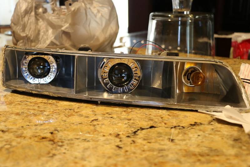

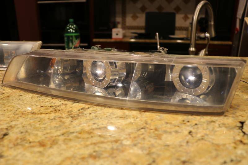

So the plan is to go quads. One projector is stronger than both OEM reflector HIDs combined that came with Gen I Mark VIIIs.
So no where near done but here is some work in progress...
Still gotta get the cut off lines at the same spot but I am liking it so far.
[video=youtube;4ln0UOeG1Is]https://www.youtube.com/watch?v=4ln0UOeG1Is&feature=youtu.be[/video]

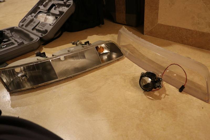

Gotta cut the shrouds next so it can fit the housing. Then have to order more projectors and HID bulbs to finish this project off for the other side.
Really great job man. If it works out well (no housing melting and such) I'd be interested in what you did exactly and what you used. I've wanted to do this for a while but I've seen a lot of failed attempts due to heat and such.
Will let you know how the other LSC housing comes off. I have 3 pairs of LSC housing and this housing was the worse out the 6. This had already been opened before so the lens came off pretty easy. I think with a heat gun it shouldn't be a problem to get the other lens off but will let you all know how that goes.
Already F'ed up one of the shrouds but now at least I know how to do the others.
And I really wished there were more attractive looking shrouds for this size projectors but these are the only one that come with it.
Alright, so using the heat gun on the other housing which had not been opened, it came out fine. I just opened two good housing since I want this to be permanent. The very first one I opened had it's inside chrome painted and was not as shiny as the originals. Now, I have to wait for the other projectors and bulbs to come in which will take around 2 weeks or so. I will prep these lights for projectors but till then this project is on hold.

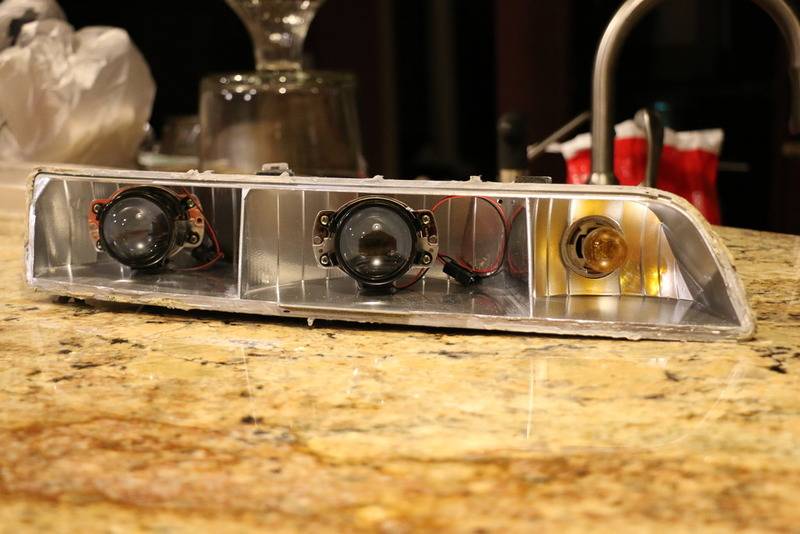

Some more progress pictures, btw I really messed up on spraying the clearcoat. I realize in the future i might even have to sand it down and possibly redo the clear.

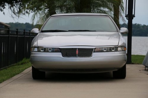

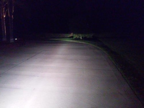

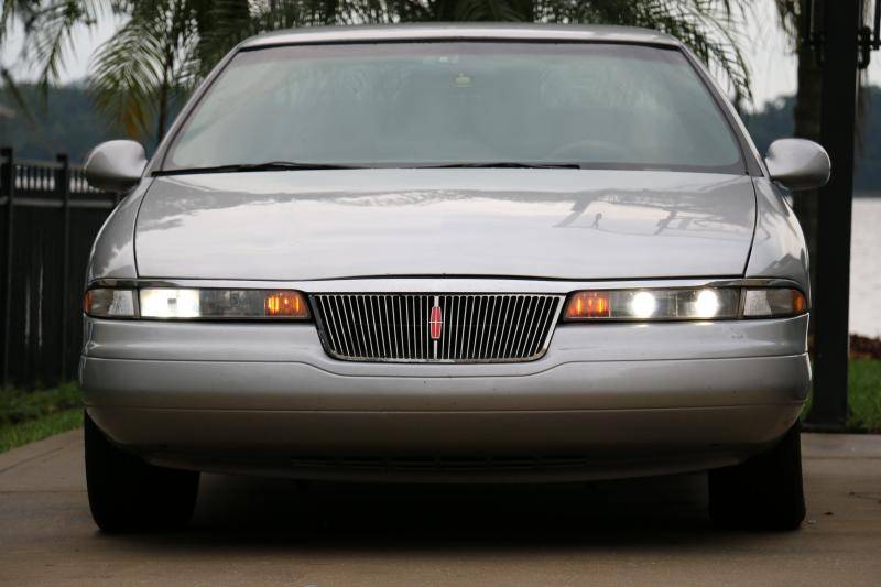

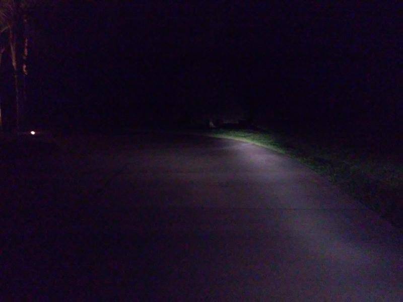

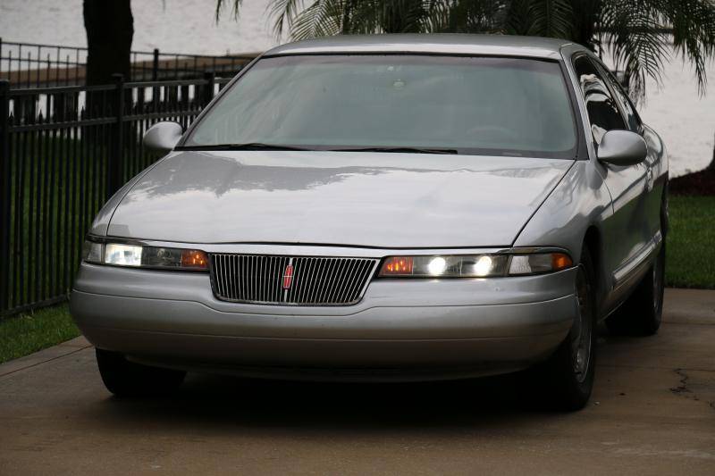

More pictures, this is just with one projector working. I took it with my phone camera to get a more realistic output of the light so the quality isn't great.

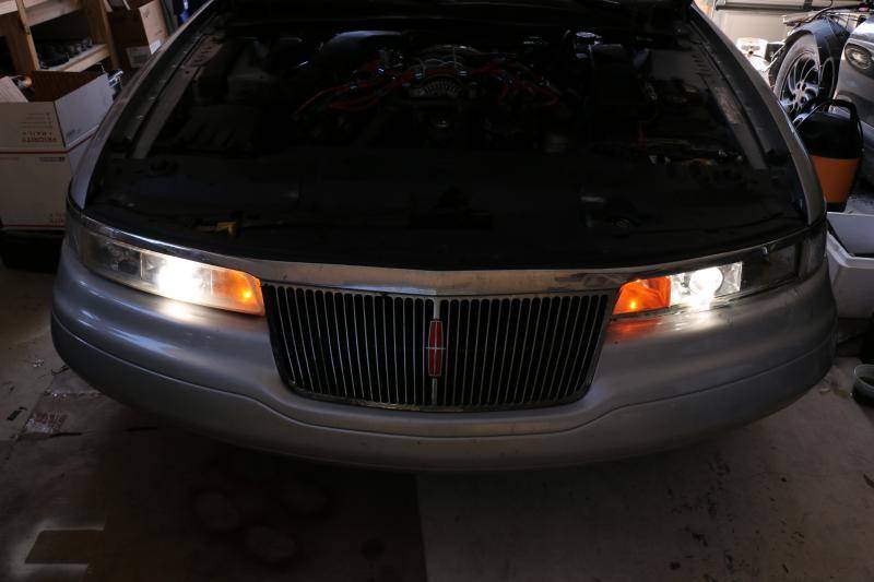

Original HID housing with ddm 35w bulb and ballast
One projector with ddm 35w bulb and ballast
Projector and original housing on
Stock
[video]https://youtu.be/PgCbvyym9lA[/video]
Projectors, this isn't quads just one projector in each housing.
[video]https://youtu.be/gj-xwZydjx0[/video]

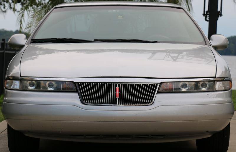

Some more pictures. I still wanna look into different shrouds or halos. I think i'm definitely not doing halos as i think more lights the more aftermarket it will look but who knows, tastes change.

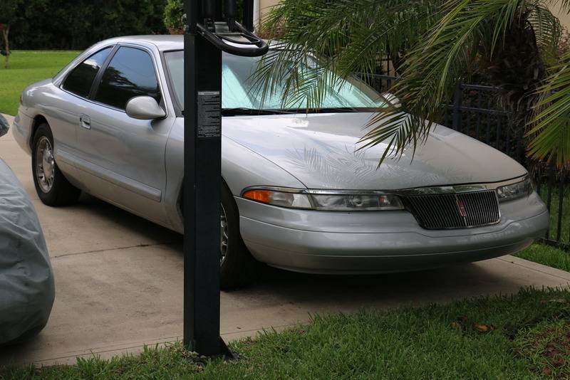

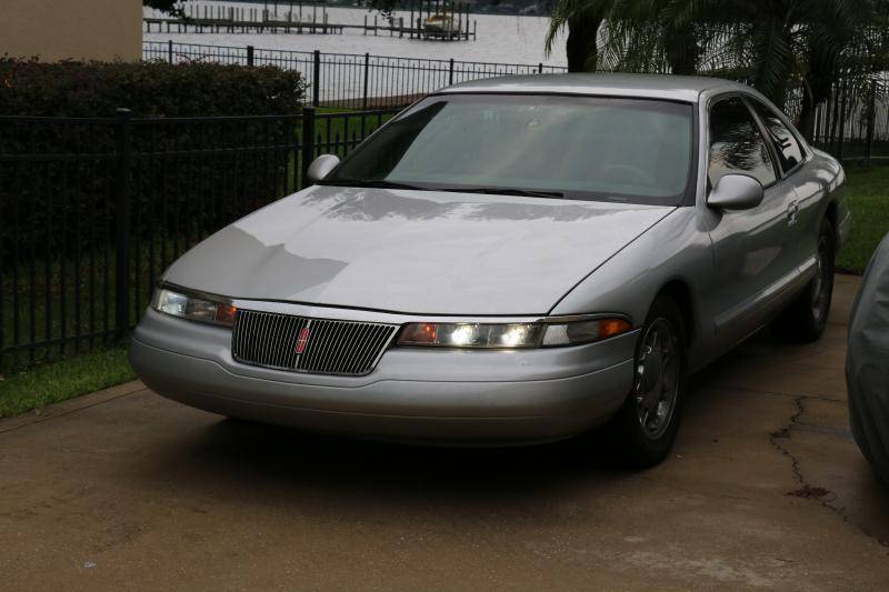

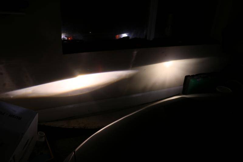

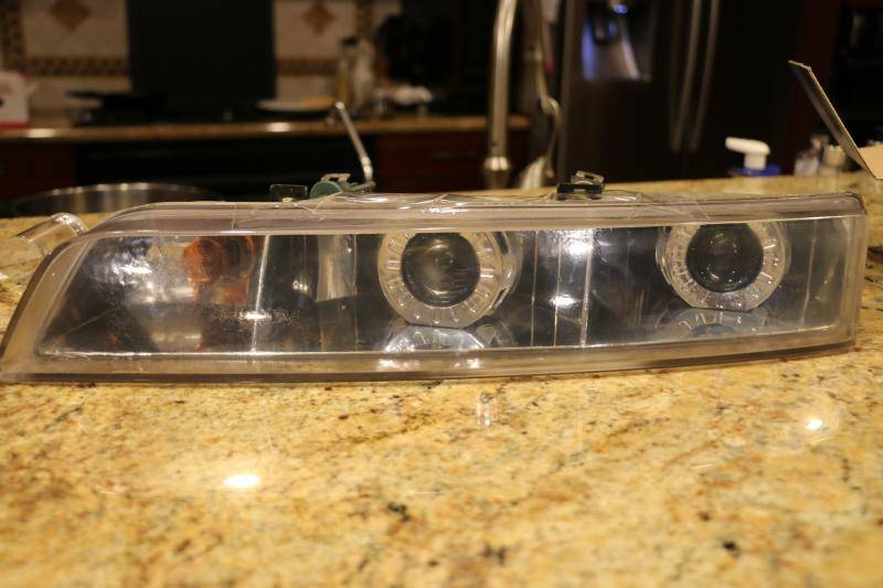

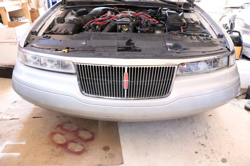

First fit trial of the new test housing. I got bored of the smaller projector so I put a 2.5 inch projector in to see if i could make it fit. I also blow molded a clear lens to fit on the halogen housings. So far the fit is doable. Still need a lot of finishing touches. The lenses actually look like crap close up but here they are next to my LSC projector setup.
Output of the light. The difference you see is more of the new clear lens verse older clear lens. The 2.5 inch vs 2 inch does have some improvements but mainly the light output is greater due to a newer lens.
