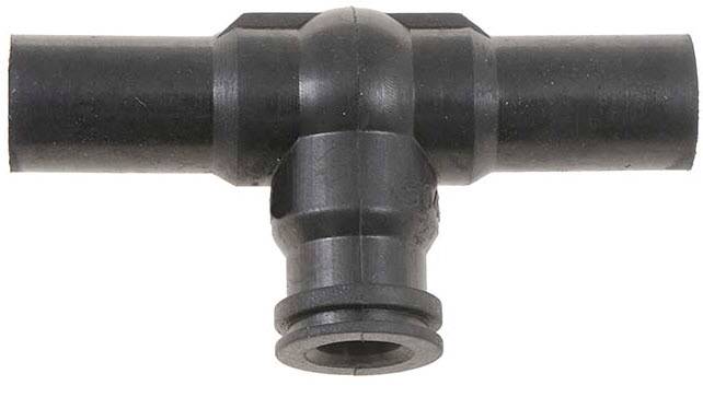

Dorman has the Emission Tee (47072) as well as the 90's. They can be sourced at most parts stores.

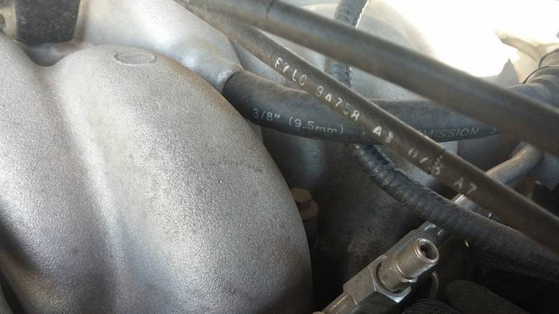

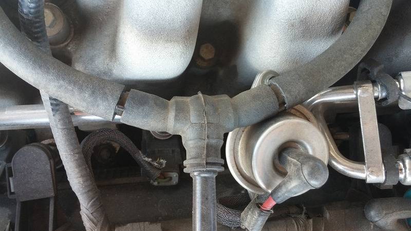

Yup, that Dorman Emission Tee is what you want. I am looking for the part number and details on the hoses, I found some generic hoses with a 90 degree, long enough (cut to fit), with right internal diameter to replace mine. There where in pretty bad shape, and the pictures below of what happens with straight hose and what it does to the tee show that isn't great either.
shows that 3/8 hose works:
You also could use a couple 90 degree barbed fittings, but that is just 4 more chances for it to leak or come apart.
Can you get the little short pieces of tube that fit between the elbows and the tee? One of mine cracked when I tried to remove it from the elbow. They are about an inch long.
