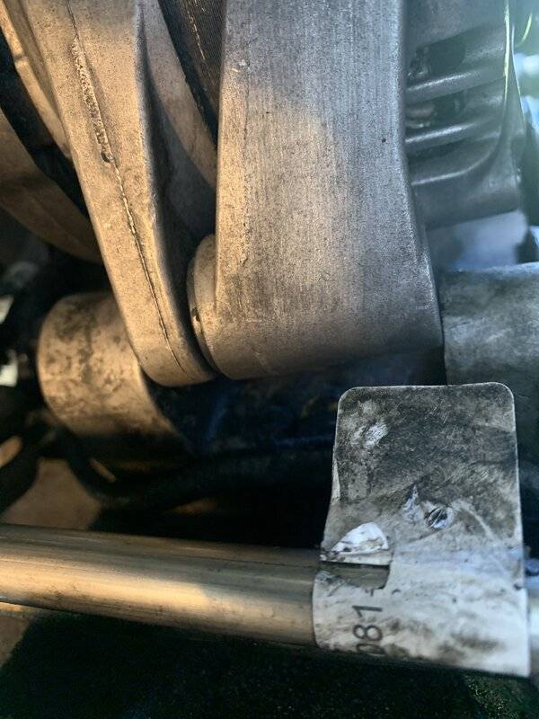

I got the bad one out, but I can’t get the lower half into the bracket. What’s the trick? There is a sleeve that extends out of the bracket bolt hole and the alternator.
I probably shouldn't admit this, but I resorted to using a grinder.
Thanks! ThTs exactly what I did. I tried to push that sleeve back through with a bolt and washer but that failed miserably!
The other annoying thing is that both my 04 service manual and the 06 manual are wrong. Or maybe my car is wrong…
The upper bolt does NOT come out. It is an upper nut, the bolt stays and you have to pop the lower part out of the bracket and then Tilt it up to slide the upper mount off the threaded rod.
