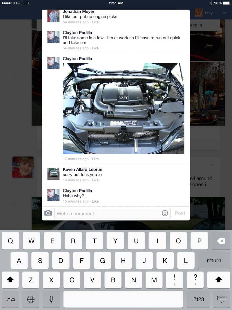

Are we sure we aren't dealing with this guy from the FB page?
Izzy, that's be absurd. To say you did something crazy, be refuted by people who know what they're talking about and frequently link to LvC, then to ask LvC about doing it???
Stranger things have happened. Especially with that guy being so adamant about the swap.
