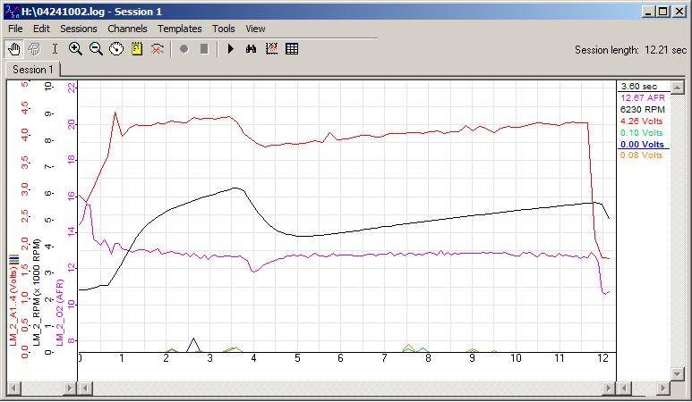

I have found that the ODB-II RPM and MAF voltage using the OBD-II Innovate Motorsports cable (p/n 3809) is VERY unreliable.
So, I decided to use the analog cable (p/n 3811) to get what I needed.
I had read that in order to get a tach signal from a Gen 2 that you need a tach adapter.
Well, not so fast.
I tried the #1 ignition coil signal from the PCM, but that didn't work.
What does work, however, is connecting the LM-2 analog RPM input to the #1 injector signal from the PCM.
On my PCM (BTC0), the #1 injector signal is a tan wire (#75) and the MAF voltage is a LB/R wire (#88). I connected the grounds for both inputs to a BK/W ground (#24).
