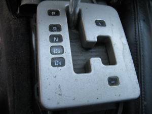

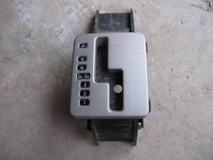

Here are pics of what is needed. My LS8 came with shiftronic and I have the regular shifter. I cant use gears 1-4 on semi till I get the right shifter. I am still looking for it. I will take a pic of my LS when I get the chance.

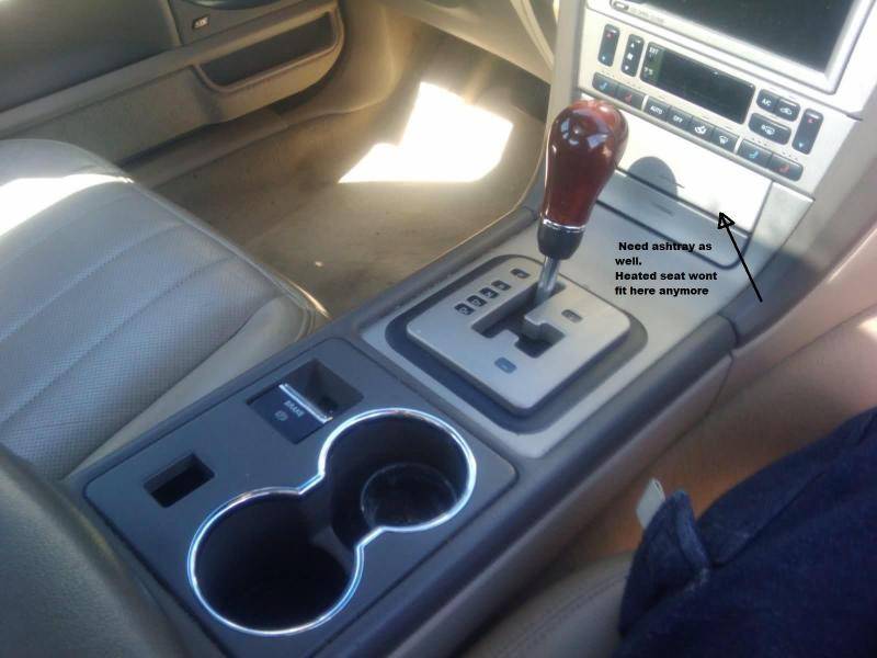

Here are pics from my car. If you get Gen 2 climate control could that work?
See what I meant about the "Check Advance Traction"
Mind the chips on the black paint. I will repaint that when I install my detachable screen. Who else has a piggy bank in the center console :D;)
I bought the car with that burn on the seat. I am looking for a seat cover.
P.S I tried posting the pics but for some reason its not working. Could I pm/email the pics to someone? Hmm nevermind. I got a message that said file is to large. I will try to re size it.

Here are pics from my car. If you get Gen 2 climate control could that work?...
No, and neither would your AC then.
The gen II has heated and cooled seats. The gen II climate control talks to an electronics module under the seats that controls the seat heating and cooling modules and fans. It won't work with the resistive wire heat elements that the gen I has.

yeah right... except for the traction button (more so the lack of being able to turn it off) cant use the heated seats, your message center always telling you that you've got a problem, and how sh!tty it looks where the old dash lines up (or doesn't line up) with the new console. I'd say there are a few more negatives than just the cost!
if i wanted a car that half the stuff didn't work on, i would just buy a kia.
I never said the traction didnt work. I can turn it on and off! You can use the heated seats if you place them somewhere else. All I have to do is press "Reset" and its off.
eek.. I've always wanted to do this mod (better arm rest / looks)... but that looks pretty bad... Not to bust the balls there but no reason to do a mod if it looks worse then it did before... Maybe if the colors matched up...
Why cant the TC button fit in that GAPING hole in the console?!?!?!
I like the mod. I think I would paint the trim in the car silver to match the silver on the console. I think that would update the interior more.
Is there a way you could cut and extend the traction control button to fit in the new hole?
