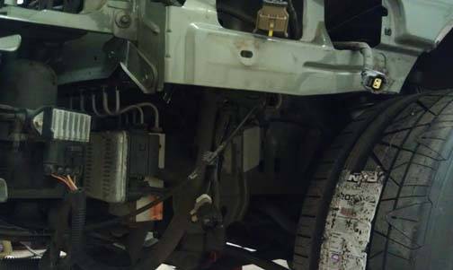

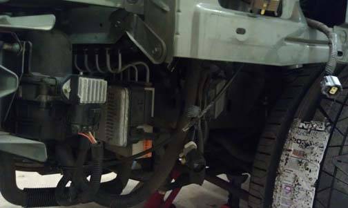

The ABS unit is a self contained unt. It is mounted behind the battery and just in front of the drivers side tire. To get access to it you have to remove the battery and unhook the brake lines with a spanner wrench. Then below where the batter sits, behind the inner splash shield, you can remove the ABS. It doesn't have anything to do with the tune.
Thanks GMAN, for some reason I thought it had something to do with the speed sensors and traction control?.?
I have everything apart right now and its easy to get to. The air pump is going away also, that part I know how to take care of.

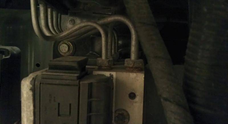

For those that have your abs unit out..
Does anyone know the fitting size and thread pitch on these? Also what type of flare they use? Did you have to redo the flare to get it to seal up?
