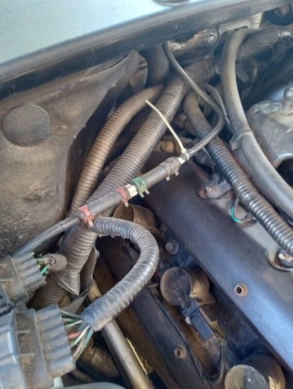

At the other end... You can get a couple vacuum line hose barbs kits from a parts store... and use 1/4" hose spring clamps and zip ties to keep from peeing all over the place

The nozzles arrived and they were, except for the color, a direct match. Fit perfectly, function perfectly. Ford Part number is 4R3Z-17603-AAC. The hoses on my LS were pretty well dried out, so I bought a Dorman 926-367 hose kit from a local O'Reilly's parts store. had to make a slight mod to it, but then it worked fine.
