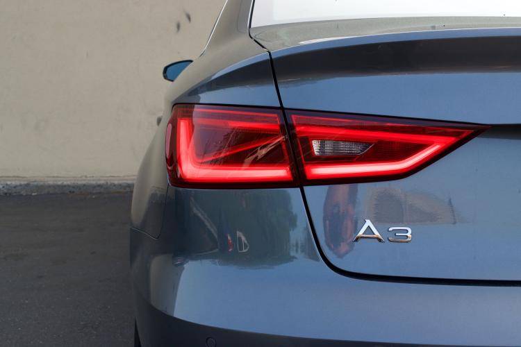

OEM examples: The C7 Corvette puts a slight delay on the lower brake lights. Center comes on, lowers come on a split second later. The most recent Audi A3 has 3 sections of lights: dedicated tails on the trunk, dual-brightness "U" or "L" continuing off the trunk light, and a dedicated strip+square brake light on the top of all this. The center brake and strip+square turn on instantly, with a slight delay on the outer U. Ambulance brakes tend to put a rapid ~ pulse, 1/2 second strobe when the brakes are first turned on.

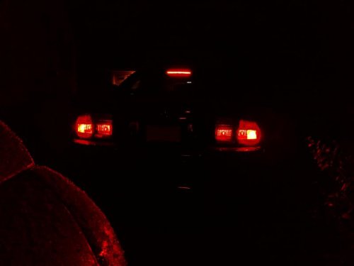

My vote is to do the Gen 2 upgrade to proper LEDs...
Or fill the housing with a solid array of Agilent Superflux red-orange LEDs (with an adjustable voltage regulator)
