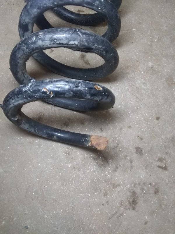

I respectfully disagree... But it might depend on the climate you live in... And/or your driving style.
I pulled this off my LS... And this is what started me on my suspension rebuild. When I went to get some NLA parts from a boneyard... I found another spring with a cracked tail.

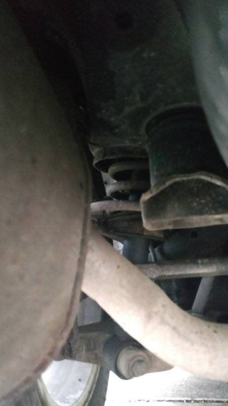

At this point I really don't care if I go OEM I just want the OEM ride quality. I took a picture of my rear left spring (will try to get more pics later) and the only issue I see is at the very bottom which is not the spring itself.

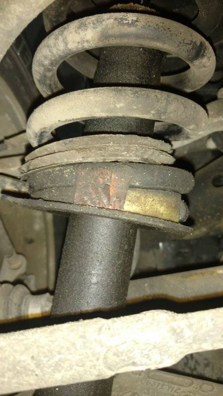

After Jacking the car up here is another pic it does not look as bad as I thought. So I just need to find a good replacement set of shocks that will just plug and play. (not talking about quick shocks I mean ones that match up to the LS)
Not too bad. Shock looks a little wet, or maybe just road debris. The bellows/boot that is part of the upper mount is missing. Don't recognize the rubber piece on top of the bottom coil. They may have been changed out once already.
The reason it all looks wet is cause I sprayed all the parts under the car with wd-40 when I got in negative degree weather. I was out of state at the time and trying to stop the squeaking a little bit but obviously that did not help. Can you please link me to the part I am missing so I can get that? I just ordered 2 shock mounts for the rear of the car and I need to get whatever hardware that will be needed to install new shocks. I am also unsure of that part at the bottom. From the distance it looked like crap to me that is what I was talking about in the first picture.
