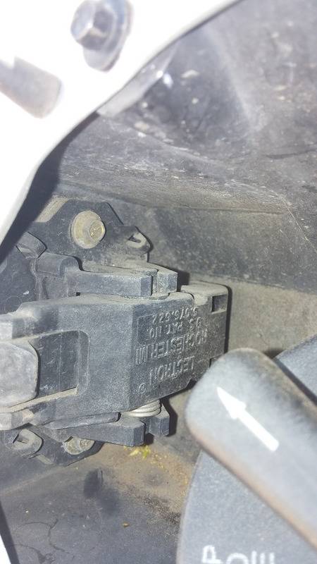

Do you hear it clicking back there when you press the button?

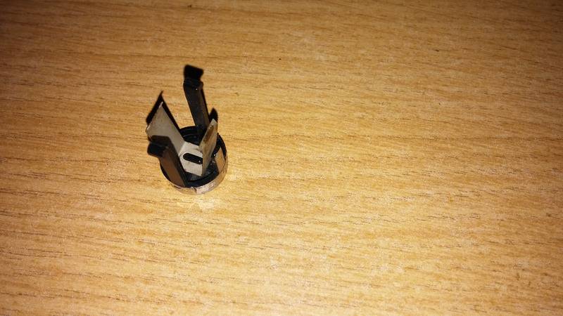

If it isn't the electric solenoid at the cover, it is likely the button. This was the first thing I broke on my 97. I pushed in the button, wind caught the door, finger slipped off, and the button popped out, breaking the catches on the legs. I gathered up the parts, but without the catches, the button wasn't useful.

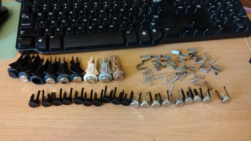

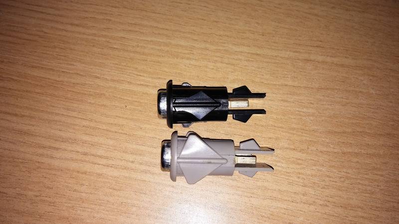

I found that many Panthers have the same button, as well as Continentals and later LS's. However they are all black housing and either black or chrome buttons. Usually all you need is the guts and button, so the housing can be reused and remain interior color. Also the Panthers buttons are not rounded if they are the trunk poppers on the dash.

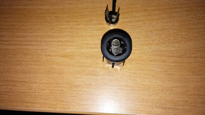

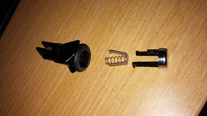

The metal piece contacts two contacts in the housing:

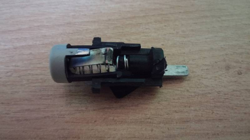

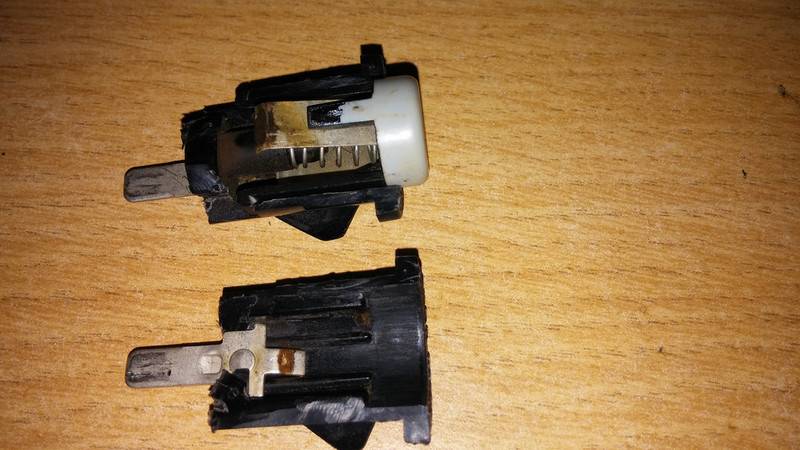

Here is a SIMILAR one cut in half (this is a trunk popper for a Panther, but same insides, just different connector and retainer for the harness)
The bottom one shows the wings that are used to retain it in the door panel. The top one they are broken, very common to see.

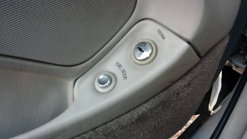

I was after a Graphite button, but chrome is fine, matches the truck popper/lock.
They rarely charge me for them at the you pull it place, if they do it is 50 cents a piece to a buck.

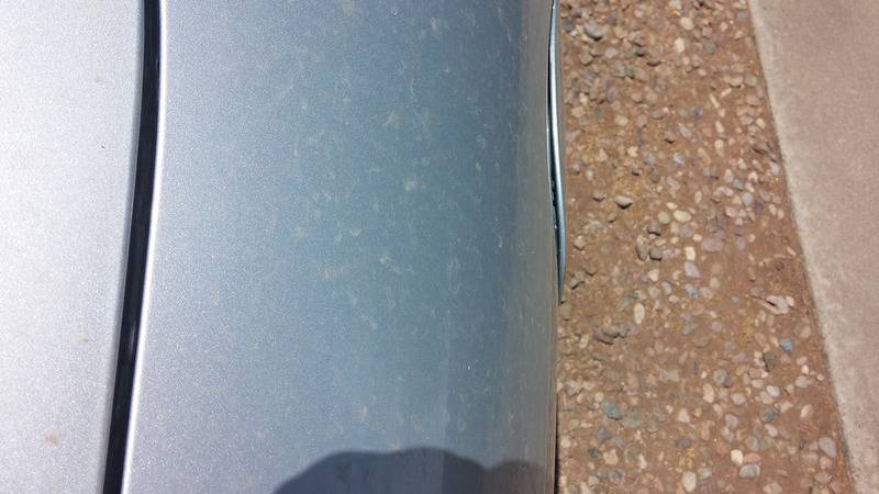

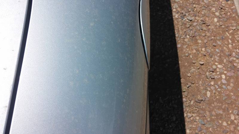

There is very little wiggle room as far as moving the popper around:

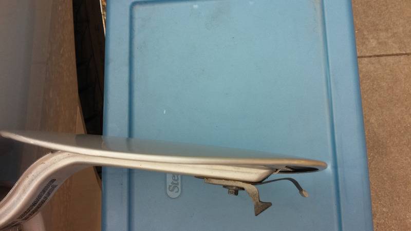

The part on the cover moves, and you can adjust the spring to make it pop open, but then it usually makes the cover stick out
If you can hear the click coming from that area when you press the button then you might just need to grab some wd40 and spray the latch flap that Bangster posted 3 pics up. Give it a good squirt.
No click is more then likely the button.
