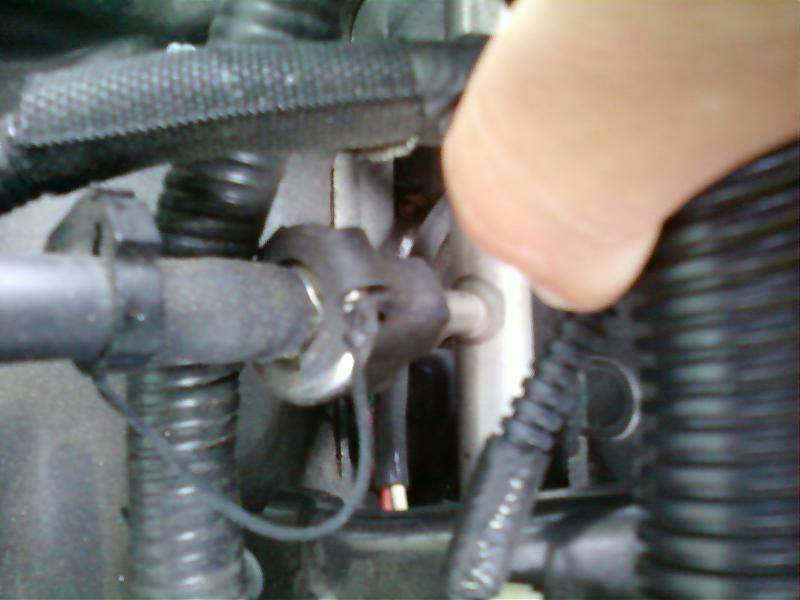

Is this lil fukker it? It doesnt have any kind of vacuum reference or anything but it seems to be the regulator, the line feeding it looks to be coming from the tank and then it goes through this and into the rail?? This is on the front drivers side rail, on the passenger side front rail there is some kind of sensor type deal that has a vacuum line that goes to the throttle body adapter and also to the EGR. Any info on what the hell is what on this engine?

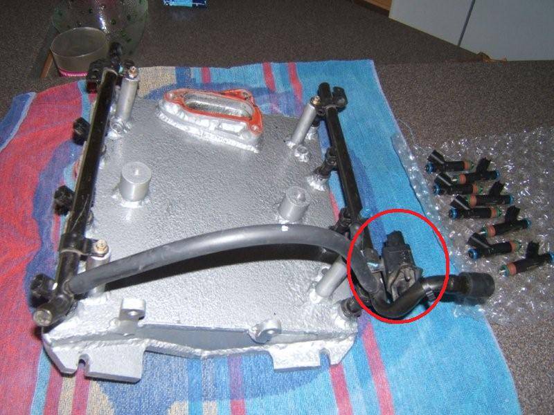

here it is on the Gen1 - there is a electrical connection (for the pressure sensor) and a vacuum reference port on the rear end
Alright I got that on the opposite side, so Im assuming something is gonna be effed up if I unplug it and put a manual adj fuel pressure regulator on it?
well - the PCM uses it (along with the vacuum) to keep the fuel pressure at 40 psi at the injector nozzle.
