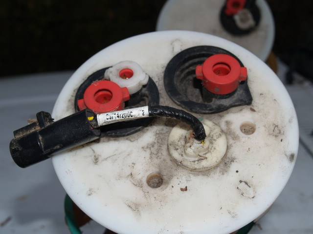

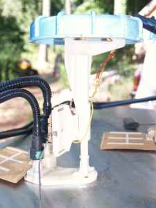

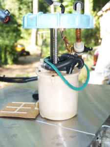

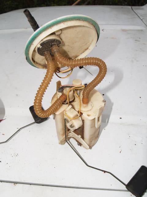

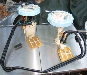

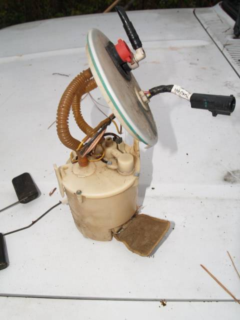

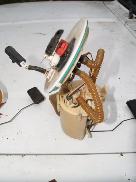

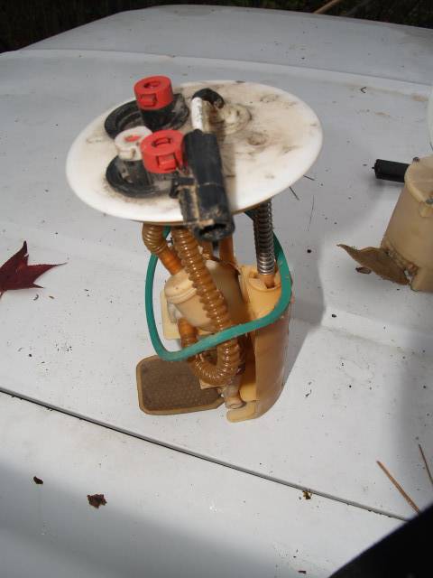

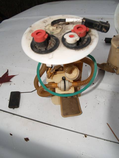

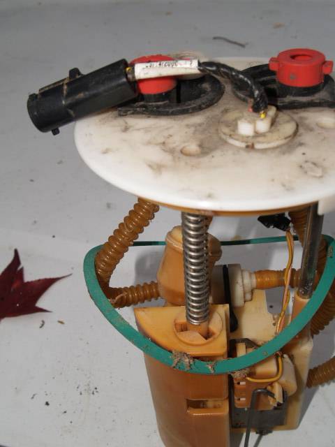

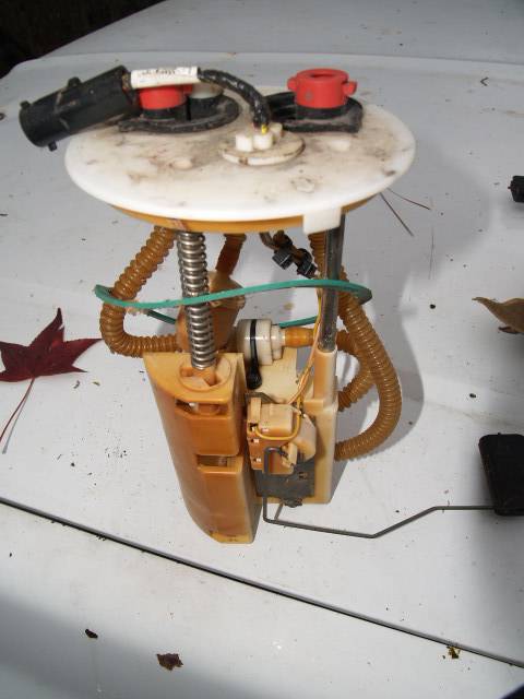

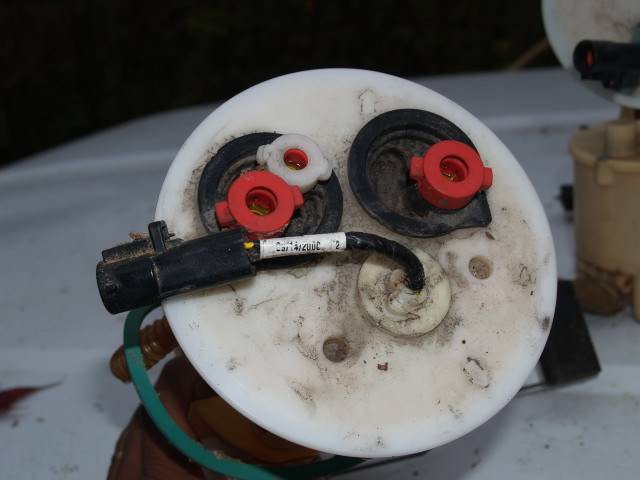

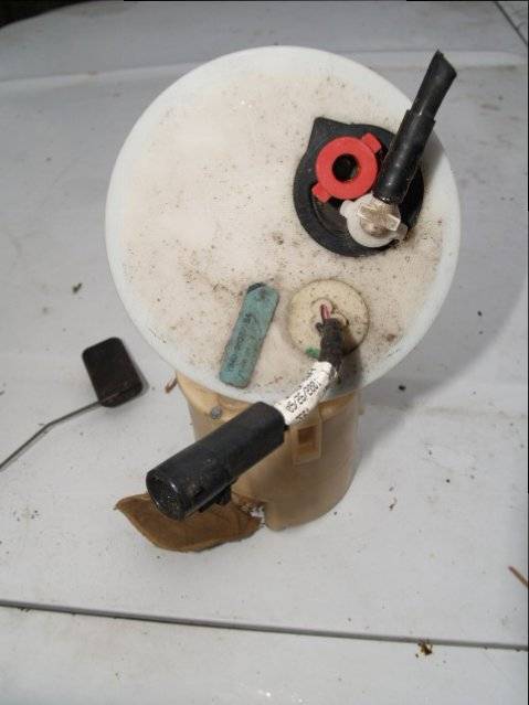

Quite naturally I have both a fuel pump & jet pump for sale...
PM an interesting offer & I'll consider it...
They are from a 2004 that was totalled earlier this year & have been stored in a sealed plastic bag.
These were my spares before we bought the new home w/o a 2 story storage building
I have an 02 and my jet pump looks very different thank you though

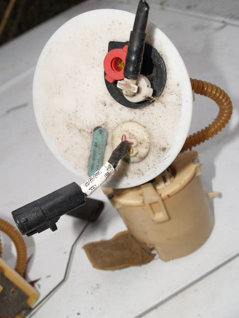

I have a set from a 2001 that was not stored in a plastic bag
I have a set, from a 2001 LS, that was not stored in a plastic bag. They have about 2 years of dust on them but should work since they have been stored in a dry location. As such, I did not offer them, but if you are interested, I will accept a decent "AS-IS" offer + S/H. Dates on the labels are 5/26/2001 & 9/14/2000 :xmas::steering
