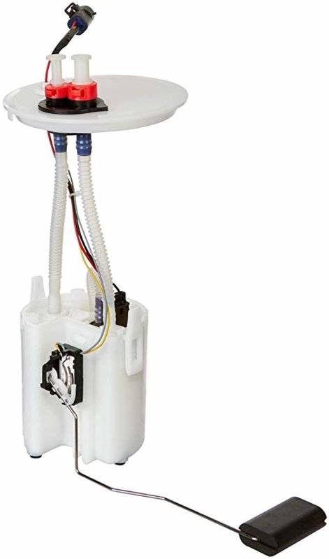

Finally found out what the cranking problems were on my 00 LS. The fuel pump went bad and it needs to be replaced. So what are the good fuel pumps out there for a 3.9L V8v

I replaced my with a Spectra ...no problems ...$89 dollars +shipping Amazon Edited: I’m talking about the whole assembly module though if just a fuel pump ...I would go with MotorCraft

Spectra Premium SP2322M Fuel Pump Module Assembly
by Spectra Premium
16 customer reviews
| 5 answered questions
Price: $78.32 Free Shipping for Prime Members
Your cost could be $68.32. Eligible customers get a $10 bonus when reloading $100.
  • Unit is designed to Original Equipment (OE) fit, form and function requirements
  • Improved OE connectors to eliminate excessive electrical resistance and provide better heat dissipation
  • Includes strainers for smoother installation process and ensures a clean fuel system upon replacement
  • Tested for voltage, amperage, resistance, pressure, and volume to ensure product performance and quality
  • Perfect fit guarantee
Thanks. I wasn’t sure what to get and kept running across the Delphi brand fuel pump. But definitely went with the brand and model you suggested. Thanks again
