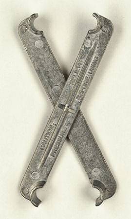

Those are replacement clips not the special tool. Autozone will have the special tool you need is a ford fuel adapter tool. It's metal and it hasba scissor action so you can get under the fuel line on top of the fuel filter, to unhatch the clip.
Those are the tool... the tool that autozone has is just a different style... lol...
replacement clips? how long have you been working on cars? the ones you are thinking of are just a different style, the ones i pictured above are the cheapies and they will disconect any fuel line or ac fitting on any mark VIII. trust me, i have two racks of those, and i have parted about 1000 mark VIII's since 99 and i have used the ones pictured every single car i parted.
Some people are easily confused...
thats what he was refering to, but the ones i posted are the same thing, only plastic and cheap, and they work just as good!! hey charlie did you call me not long back? i lost your number do you want me to give you a ring, did you need something?

the best advice i can give on how to remove the filter (with the tool) is to insert the tool a little then push the filter in as far as it will go then push the tool in the rest of the way. if the lip on the filter is holding tension on the clips it wont release and if it still gives you a hard time fill the hell out of it with pb blaster and try again, also twisting the filter helps too

the tool wont always work if you dont push the filter in like chicken mentioned, i have had to do that too, slip the tool in and shove the filter into the line harder by hand and walla!!! works like a charm.
