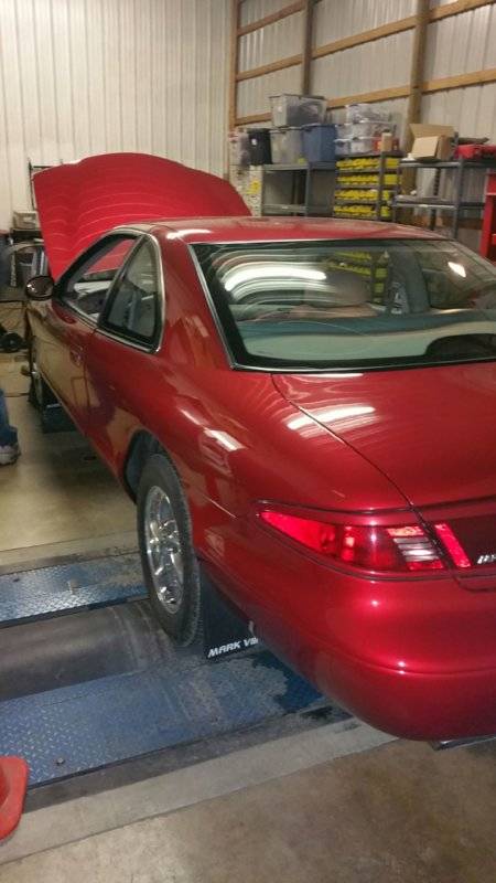

That's an interesting shot. That's more difference than I would have thought comparing the speed/revs to the stock 3.02 gears of my base. The 3.02's run 92mph @ 2500 revs. Question is, whats your average mpg?
21mpg +/-1 depending speed/how/where I’m driving.
Very nice! man you'v got those head lights polished up like new. I have to live with spider cracking on the inside. :(
I love the chrome delete of the LSC, and I swear the red looks clearer on yours then mine, and what would the under drive pulleys do on a na engine I know they increase boost on forced induction, and I'd bet the farm that tune has a fair bit to do with the mpg.

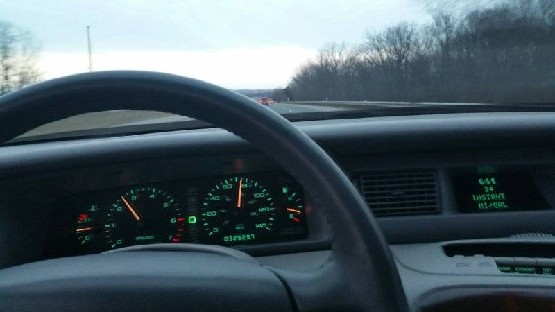

No risk of overheating at all. I run a 170* thermostat with the fan commanded to come on earlier through the tune. It will idle all day in 95* without breaking a sweat let alone going down the highway. Look at the temp gauge in the pic.
My son and were Longhaulers in PowerTour this year with this car. Piece of cake!
