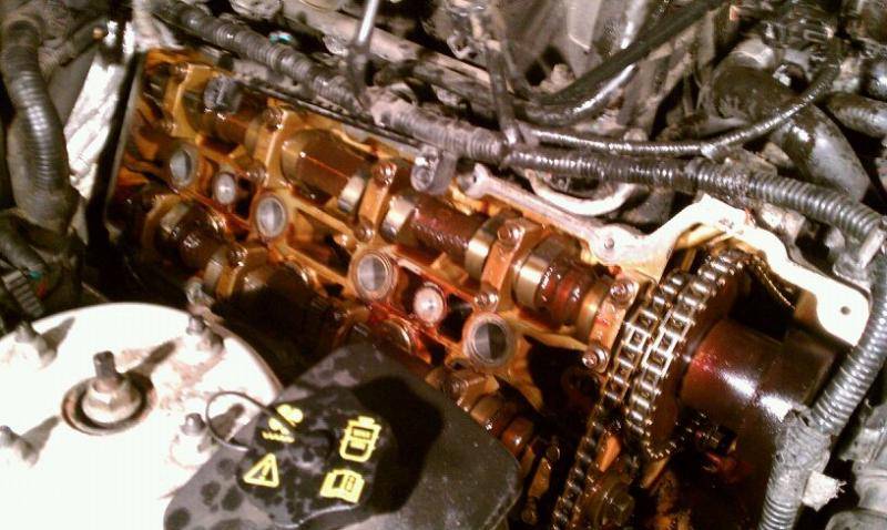

As you can see from the photo, the engine has little to no sludge build-up (I have always kept up on the oil changes) and looks pretty clean. I checked all the camshaft mounts and none were loose and I also felt the cams, all seemed smooth with no marks or wear. As for the lifters, etc; I am not sure how I am going to check those without getting deeper into the engine as I am sure I am going to need to pull some parts off the front to get to the flywheel/pulley to put a breaker bar on it to turn it?
Any suggestions or ideas would be appreciated. As for now, I have it parked in my garage, waiting for the next step, whatever that is...

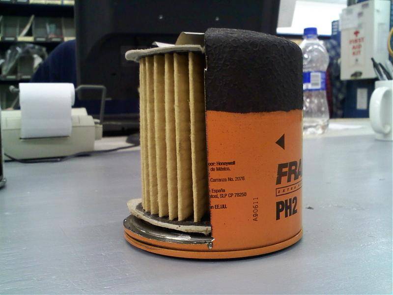

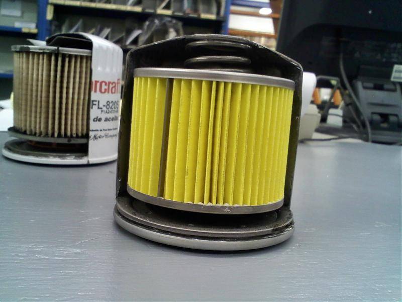

Also, FYI, I am using a Fram Oil Filter and I have read a lot here that people recommend a Motorcraft instead because the Frams don't allow the oil to flow as well as with the Motorcraft. So could that be a cause as well? (I find it absurd that a simple oil filter could cause that much noise in the top-end, but I won't count it out completely, yet.)
I may just go and get a Motorcraft filter anyway, just to eliminate that possibility. LOL
Old internet urban legend from the 90's. I've been using nothing but Fram filters from WalMart in my 02 LSE v8 since I bought her with 8 miles on her brand new. I now have 139k miles and the engine is just as smooth as she was when I purchased the car

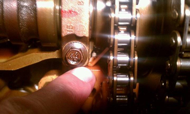

Secondary tensioner is broken...
After looking closer I realized the tensioner is broken. You can see the piece broken and wedged between the pulley and cam mount. I pulled it out with a pair of tweezers. Can I simply remove the broken tensioner as-is and replace with a new one without tearing the engine down too much? (As in remove only the two mounting bolts?)
BTW, the flats of the two cams aren't facing straight up, but they both appear to be facing the same direction. But I assume if one is off a tooth it would be hard to tell anyway?

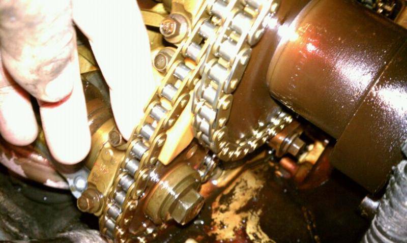

After a closer inspection the cam on the secondary chain is indeed off a tooth or two. So my game plan is to replace that secondary tensioner and while I am at it, align that cam's flat up with the cam on the primary chain.
I don't see a need in replacing anything else since the primary chains are tight and everything else seems fine.
