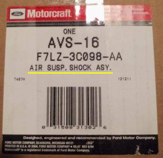

I think you need new front air shocks and you should be set. AVS-16 & AVS-17 are what you need.

Yes, I was just on there. $338 shipped for the AVS-16 and $331.12 for the AVS-17 and I doubt they will be found any cheaper. Be nice if they were free shipping. $658.72 for both really isn't that bad. I paid $723 for both but that was before I really dug deep and found the good prices. Seems like I would have done that before buying lol. I was in a hurry I guess.

Not 2nd rate. They are NIB just like autopartstomorrow has or had. That's being said so you'll jump at those $435 air shocks. $723 was enough for me, I ain't paying $870 + shipping of around $40 but I do recommend Eddies compressors all day long.
