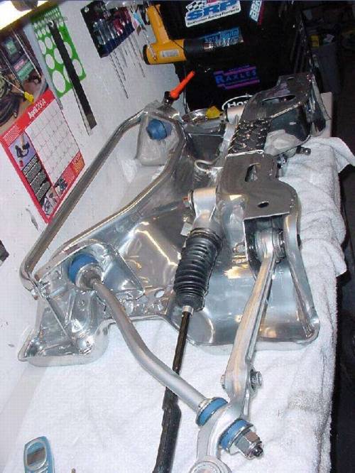

I used the Blues on this build and they suck'd, swapped em out with poly's from MN12 preformance back when Rich was still in the mix. I would strongly suggest going with Ford OEM's for this since I have had many Moog SRB's fail (even the black ones).
-Scott
**Notice Big Scott's Diamond plate jack mod!
Wow! Now thats a killer looking k-member!
